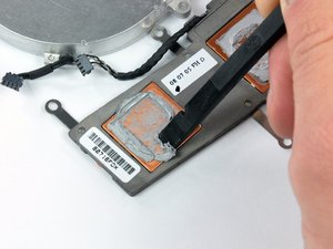

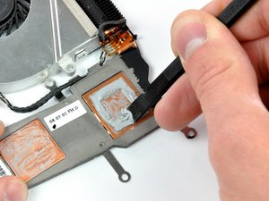

  • Use the flat end of a spudger to scrape off as much solidified thermal paste from the copper core(s) of the heat sink as possible.
Image 1/1:
  • After scraping off the solidified thermal paste, a residue is still present on the copper core(s).
Image 1/2: Once the surface is clean, use a new coffee filter or cloth to apply a drop of ArctiClean Thermal Surface Purifier to remove any oils and prepare the surface. Image 2/2: Do not touch either the chip or the heatsink, or allow any dust or debris to get on them. Even a fingerprint can be a major obstacle to thermal transfer on a chip.
  • Use a coffee filter or a lint-free cloth with a drop of ArctiClean Thermal Material Remover to clean the thermal paste residue off the thermal contact surface of your heat sink.
  • Once the surface is clean, use a new coffee filter or cloth to apply a drop of ArctiClean Thermal Surface Purifier to remove any oils and prepare the surface.

Any 70% or up Isopropyl alcohol will do the trick in removing the paste.
I use those cotton ear sticks to clean the paste off. You can find this bottle in pretty much any dollar or drug/pharmacy store.
I don't use ArctiClean Thermal Material Remover because is way too expensive and is hard to get it shipped (simply put: too much hassle).
Scorps - Reply
too expensive? I got mine for less than 5 USD. On a further note, I saw a video on youtube and a chap who use to use Alcohol switch to ArctiClean Thermal Material Remover and now swears by it, he said it was much more effective at dissolving the old thermal paste and in fact he demonstrated the removal process, in a few seconds he wiped it all off clean. Worth the money. It is NOT expensive though, not at all.

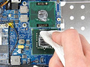

Image 1/1: Do not use any metal objects for this procedure. Be careful not to break any components on the processor's surface, or get any thermal compound loose on any components (conductive pastes could cause  problems).
  • Use the flat end of a plastic spudger to remove any solidified thermal paste from the surface of the processor(s).
  • Do not use any metal objects for this procedure. Be careful not to break any components on the processor's surface, or get any thermal compound loose on any components (conductive pastes could cause problems).
you can also use a junk credit card or similar, or a plastic spoon

Image 1/2: Use a new coffee filter or cloth to apply a drop of ArctiClean Thermal Surface Purifier to remove any oils and prepare the surface. Image 2/2: Allow the processor(s) to dry completely!
  • Again, use a coffee filter or lint-free cloth and a drop of ArctiClean Thermal Material Remover to clean any thermal paste residue off the processor surface.
  • Use a new coffee filter or cloth to apply a drop of ArctiClean Thermal Surface Purifier to remove any oils and prepare the surface.
  • Allow the processor(s) to dry completely!
