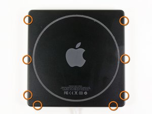

    1. Apple USB SuperDrive Optical Drive Replacement, Optical Drive: step 1, image 1 of 2 Apple USB SuperDrive Optical Drive Replacement, Optical Drive: step 1, image 2 of 2

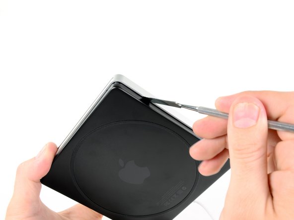

      • To open the SuperDrive we must remove the lower case.
      • The lower case is attached by 8 clips.
      • 6 along the sides
      • 2 on the back
      Ask FixBot

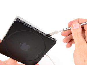

    2. Apple USB SuperDrive Optical Drive Replacement: step 2, image 1 of 2 Apple USB SuperDrive Optical Drive Replacement: step 2, image 2 of 2

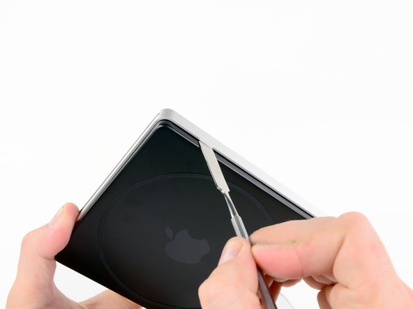

      • Insert a metal spudger down between the black lower case and the aluminum upper case.
      • Lightly pry back to gently lift the clip out of place, just far enough to disengage.
      • Don't lift to far, or the clip on opposite side of drive will be wedged in place.
      Ask FixBot

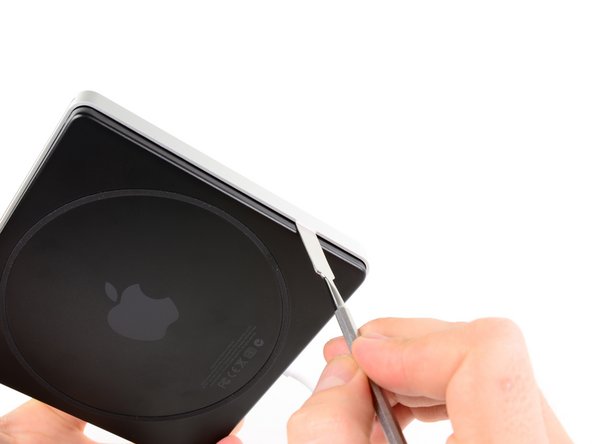

    3. Apple USB SuperDrive Optical Drive Replacement: step 3, image 1 of 2 Apple USB SuperDrive Optical Drive Replacement: step 3, image 2 of 2

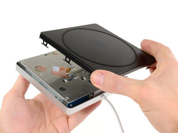

      • Repeat Step 2 for each of the 8 clips.
      • Continue until all of the clips have been disengaged and the lower case is free.
      Ask FixBot
    4. Apple USB SuperDrive Optical Drive Replacement: step 4, image 1 of 1
      • Lift off and set aside the lower case.

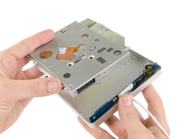

    6. Apple USB SuperDrive Optical Drive Replacement: step 6, image 1 of 2 Apple USB SuperDrive Optical Drive Replacement: step 6, image 2 of 2
      • (A1270) Lift the optical drive from the thick side, then pull out.
      • (A1379) You will need to be even more careful with this model, as there is less wiggle room. Peel back the insulation tape to see the connector.
      • Be careful of the wires still running from the drive to case.
      • When re-installing the optical drive insert tongue in groove side first, as pictured.
      Ask FixBot

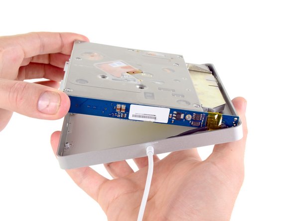

    7. Apple USB SuperDrive Optical Drive Replacement: step 7, image 1 of 2 Apple USB SuperDrive Optical Drive Replacement: step 7, image 2 of 2

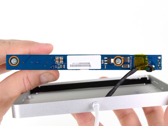

      • (A1270) Remove screws holding the board to optical drive.
      • two 3.8 mm #00 Phillips head screws.
      • (A1379) There are similar screws present here, but they only remove the metal shielding plate which gives further access to the USB wires
      • Unfortuantely, you cannot disconnect the drive any further without breaking out a soldering iron.
      Ask FixBot

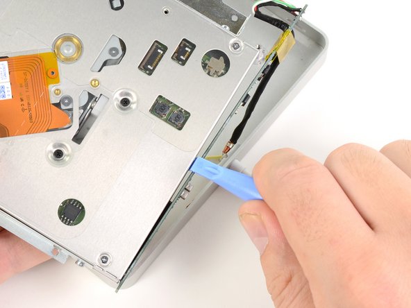

    8. Apple USB SuperDrive Optical Drive Replacement: step 8, image 1 of 2 Apple USB SuperDrive Optical Drive Replacement: step 8, image 2 of 2
      • Use a plastic opening tool to remove the board from the optical drive.
      • The optical drive is now free from the case.
      Ask FixBot
