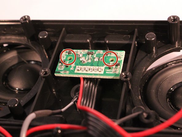

    4. Altec Lansing BoomJacket Power Button Replacement: step 11, image 1 of 2 Altec Lansing BoomJacket Power Button Replacement: step 11, image 2 of 2
      • You will now see the motherboard for the power button.
      • Remove the 2 screws holding the motherboard into place.
      Ask FixBot
    5. Altec Lansing BoomJacket Power Button Replacement: step 12, image 1 of 1
      • Pick up the motherboard and take it out of the slot.
      Ask FixBot
    6. Altec Lansing BoomJacket Power Button Replacement: step 13, image 1 of 1
      • Disconnect the power button motherboard from the speaker motherboard.
      Ask FixBot
