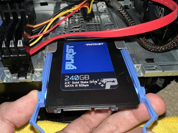

    • Insert the hard drive into the tray using the four small squares on the side of the disk as shown by the red circles. There should not be any movement if inserted correctly.
    • If you need to remove an old hard drive before inserting the new one, gently separate the blue tray from the hard drive. You will only need to pull enough for the tray to come out of the hard drive's tiny hole slots. Once one side is loose, the other side will come out on its own, then follow the red bullet to insert a new drive.

    • Push the tray, with the hard drive inserted, back into its original position until you hear a small "click." Your hard drive is now inserted into the computer, but you still need to plug it in.

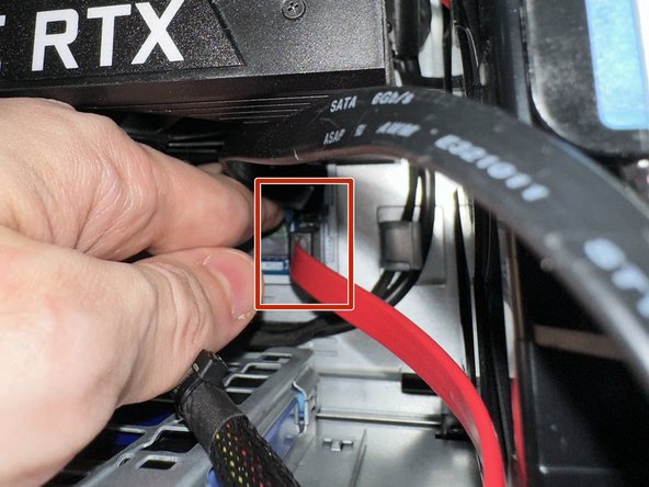

    • Hard drives require two individual cables in order for them to work as intended: a power supply, and a data cable. This particular computer comes with an additional power supply cable, but you may need to provide your own data, or SATA cable.
    • Plug the SATA cable into the computer and the hard drive. The SATA cable plugs into the smaller connector on the right side of the hard drive, and just beneath the graphics card inside the computer.

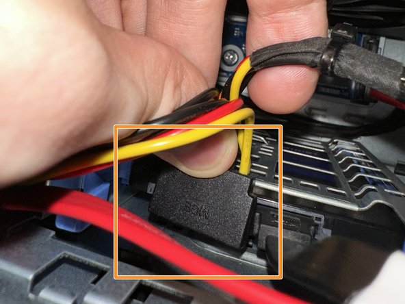

    • Plug the power supply cable into the hard drive. The power supply cable plugs into the larger connector on the left side of the hard drive.
    • You only need to plug in one end of the power supply cable, as the other end is already connected in the computer.
