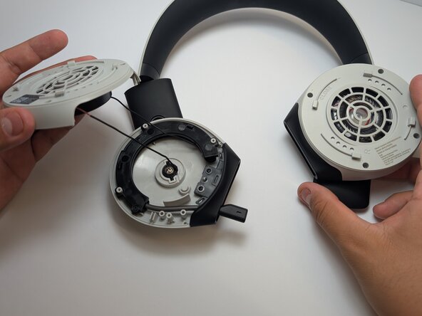

    1. Alienware AW510H Audio Port Replacement, Microphone Assembly: step 3, image 1 of 2 Alienware AW510H Audio Port Replacement, Microphone Assembly: step 3, image 2 of 2
      • Remove the four 8.5mm screws found on the base of the left ear cup housing using a Phillips #0 screwdriver.
      Ask FixBot
    2. Alienware AW510H Audio Port Replacement: step 4, image 1 of 1
      • Gently lift the plastic shell, being cautious of the wire that is still attached.
      Ask FixBot

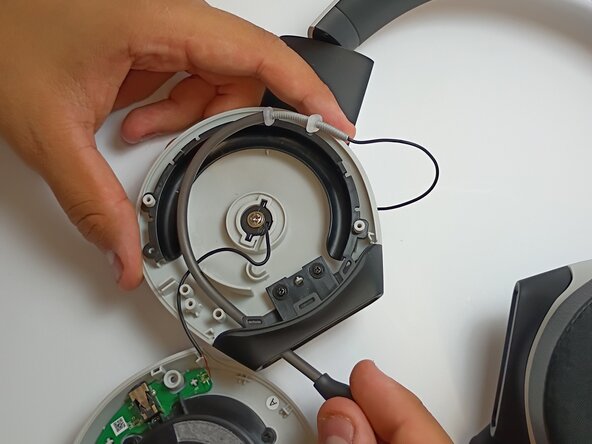

    3. Alienware AW510H Audio Port Replacement: step 5, image 1 of 1
      • Remove the 5mm screw from the microphone cover using a Phillips #1 screwdriver.
      • Follow the microphone boom connection to the driver and motherboard.
      • The retractable and bendable microphone is located on the left side.
      Ask FixBot
    4. Alienware AW510H Audio Port Replacement: step 6, image 1 of 1
      • If there is a protective plastic or glue coating on top of the solder, scrape it off using a metal spudger before desoldering.
      Ask FixBot
    5. Alienware AW510H Audio Port Replacement: step 7, image 1 of 1
      • Use a soldering iron to disconnect the wire connecting the microphone to the motherboard.
      Ask FixBot
