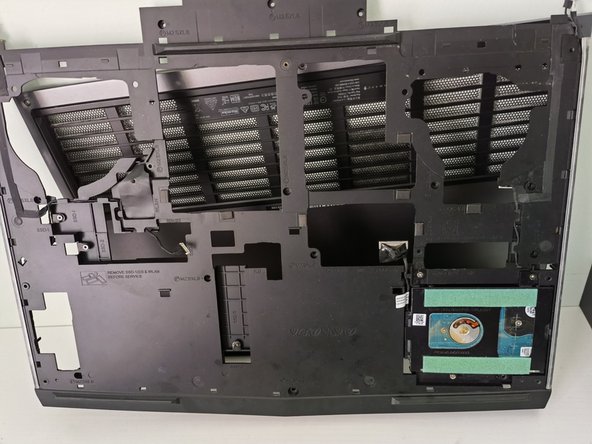

    3. Alienware 17 R5 Battery Replacement, Remove the Second Layer of Casing that Protects the Components: step 3, image 1 of 2 Alienware 17 R5 Battery Replacement, Remove the Second Layer of Casing that Protects the Components: step 3, image 2 of 2
      • Remove the second layer of casing that protects the battery.
      • Make sure not to bend and or damage this layer of casing that protects all of the components while removing it. Remove any screw and or unclip any clip that may be holding it together.

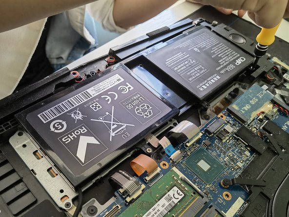

    5. Alienware 17 R5 Battery Replacement, Remove the Battery: step 5, image 1 of 2 Alienware 17 R5 Battery Replacement, Remove the Battery: step 5, image 2 of 2
      • Using a Phillips #0 screwdriver, remove the screws holding down the battery.

    6. Alienware 17 R5 Battery Replacement, Installing the New Battery: step 6, image 1 of 3 Alienware 17 R5 Battery Replacement, Installing the New Battery: step 6, image 2 of 3 Alienware 17 R5 Battery Replacement, Installing the New Battery: step 6, image 3 of 3
      • Place the new battery in the correct position and reinstall the screws that hold the battery in place. Next , connect the cable into the battery connector.

This guide needs a lot of work. Step 3 is especially problematic, leaving out the need to remove the panel over the connectors including how to unclip it, also disconnecting the light bars on the sides and the HDD. And how to uncip the plastic panel you are unhooking everything else to do. It needs more than just better pictures. It was enough I didn't feel right giving the credit by saying I'd made the repair (which I did).
