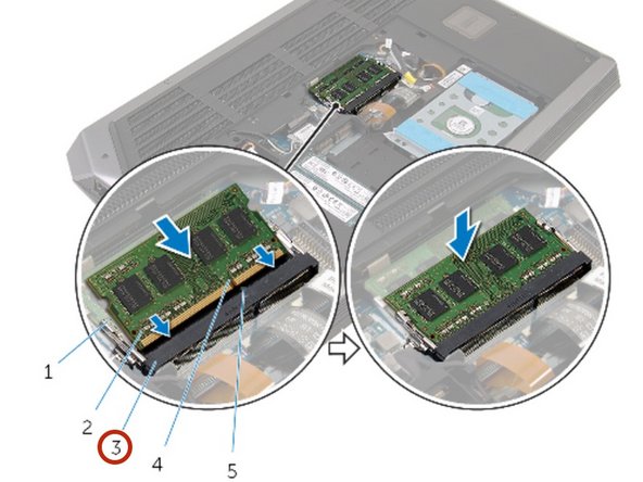

    3. Alienware 17 R2 Memory Modules Replacement, Aligining the Notch: step 3, image 1 of 1
      • Align the notch on the new memory module with the tab on the memory- module slot.
      Ask FixBot
    4. Alienware 17 R2 Memory Modules Replacement, Installing Memory Module: step 4, image 1 of 2 Alienware 17 R2 Memory Modules Replacement, Installing Memory Module: step 4, image 2 of 2
      • Slide the memory module firmly into the slot at an angle and press the memory module down until it clicks into place.
      • If you do not hear the click, remove the memory module and reinstall it.
