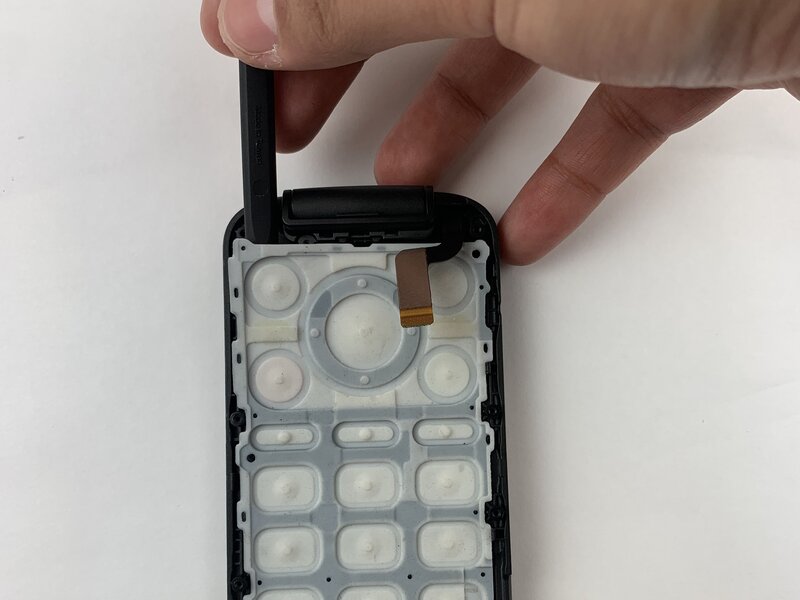

    1. Alcatel Go Flip 4 Keypad Replacement, Keypad: step 8, image 1 of 2 Alcatel Go Flip 4 Keypad Replacement, Keypad: step 8, image 2 of 2
      • Using the spudger, peel off the keypad.
      • Remove the keypad from the phone.
