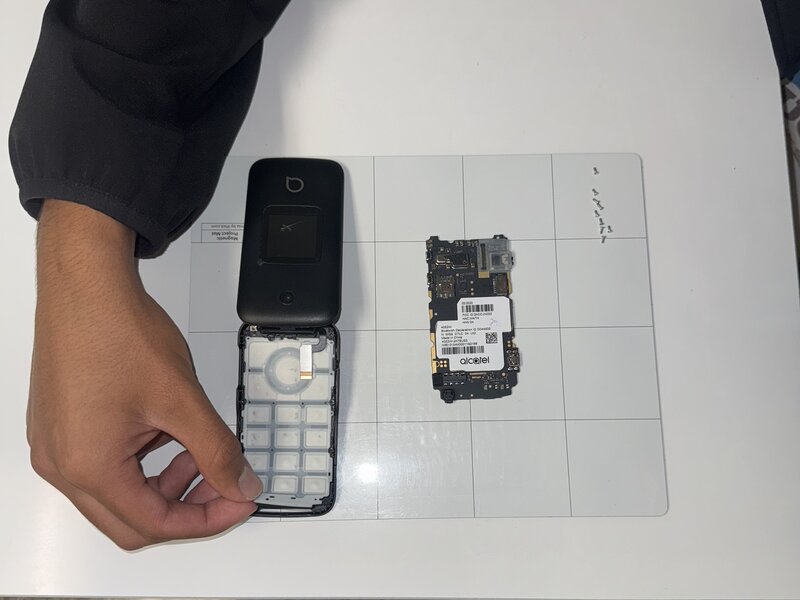

In order to replace the number pad on the Alcatel Go Flip 3 you need to follow the steps from our "motherboard replacement" guide.

    1. Alcatel Go Flip 3 Keypad Replacement, Keypad: step 7, image 1 of 1
      • Grab one corner of the number pad and lift up to remove it from the phone.
