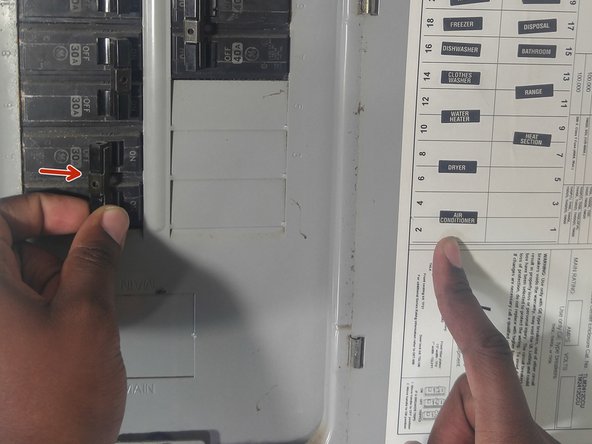

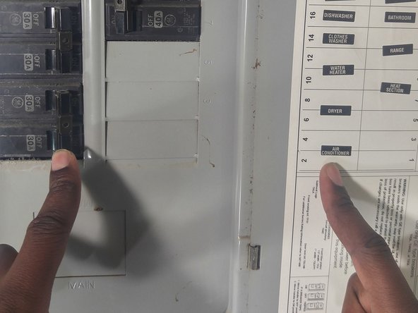

    • Before you begin, locate the circuit breaker switchboard for the housing unit.
    • Find the air conditioning breaker that’s typically labeled inside the breaker's panel cover.
    • Turn off the electrical breaker switch that supplies the air conditioning thermostat.

    • Locate the circuit breaker switchboard for the housing unit.
    • Locate the air conditioning electrical breaker switch.
    • Turn on the electrical breaker switch that the air conditioning thermostat supplies.
