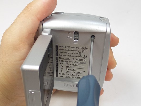

  2. Aiptek Pocket DVII 1.3M LCD Speaker Replacement: step 2, image 1 of 1
    • Unscrew the three 4mm screws from the battery side of the device. Use a Phillips screw driver.
