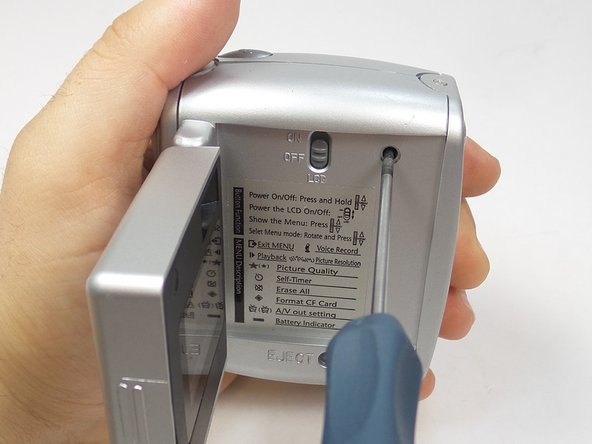

  3. Aiptek Pocket DVII 1.3M LCD Lens Assembly Replacement: step 3, image 1 of 1
    • Remove the four screws from the back side.

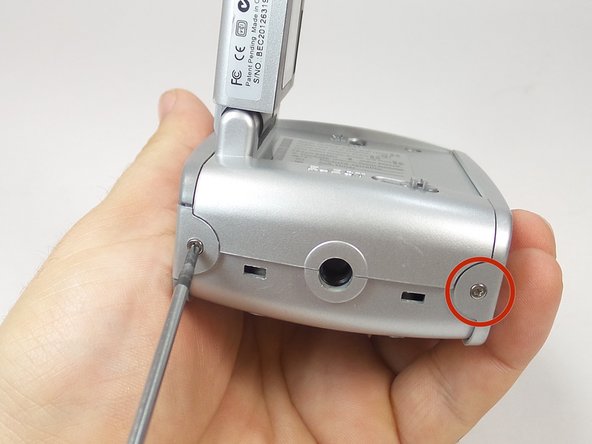

  5. Aiptek Pocket DVII 1.3M LCD Lens Assembly Replacement: step 5, image 1 of 2 Aiptek Pocket DVII 1.3M LCD Lens Assembly Replacement: step 5, image 2 of 2
    • Remove the two screws from the top side of the device.
    • Remove the two screws from the bottom side of the device.

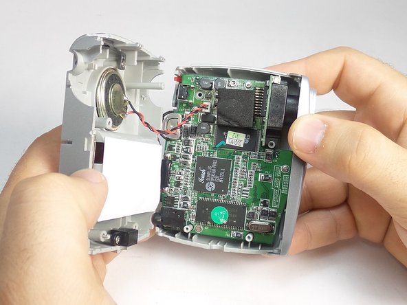

  7. Aiptek Pocket DVII 1.3M LCD Lens Assembly Replacement: step 7, image 1 of 1
    • Pull back the front cover so that you can dislodge the side cover.
  8. Aiptek Pocket DVII 1.3M LCD Lens Assembly Replacement: step 8, image 1 of 1
    • Unfold the device and be careful not to tear the black and red power supply wires.
  9. Aiptek Pocket DVII 1.3M LCD Lens Assembly Replacement: step 9, image 1 of 1
    • Remove the four screws from the motherboard.
  10. Aiptek Pocket DVII 1.3M LCD Lens Assembly Replacement: step 10, image 1 of 1
    • Take out the motherboard while disconnecting the flip screen's cable from underneath.
  11. Aiptek Pocket DVII 1.3M LCD Lens Assembly Replacement: step 11, image 1 of 1
    • Replace the Lens Assembly board.
    • Be careful not to damage any of the pins. Pull the board linearly.
