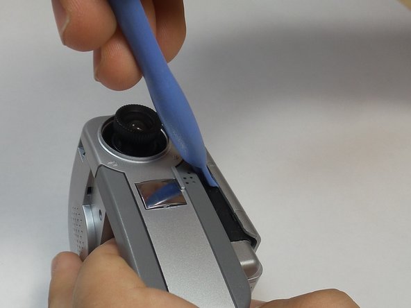

  3. Aiptek Pocket DVII 1.3M LCD Display Screen Replacement: step 3, image 1 of 1
    • Using an opening tool, separate the cover from the screen.
    • The cover won't completely come off. This will happen in the next step.
    • Don't be afraid to use a little more force.
  4. Aiptek Pocket DVII 1.3M LCD Display Screen Replacement: step 4, image 1 of 1
    • Using an opening tool remove the outside cover of the flip screen.
    • Move the cover towards the lens and then away from the screen.

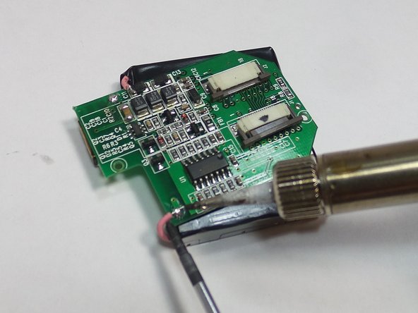

  9. Aiptek Pocket DVII 1.3M LCD Display Screen Replacement: step 9, image 1 of 1
    • Turn the circuit board over and with a soldering gun remove the two wires on each end.
    • Use a screwdriver to pull the loosened wire away.
  10. Aiptek Pocket DVII 1.3M LCD Display Screen Replacement: step 10, image 1 of 1
    • With the wires no longer holding the circuit board and screen together, remove and replace the broken screen.
