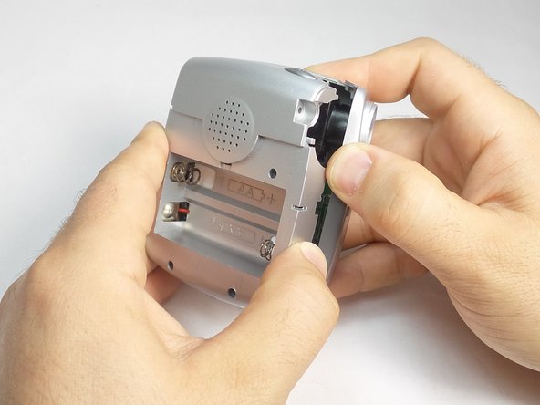

    • Remove the battery cover.
    • Remove the batteries.

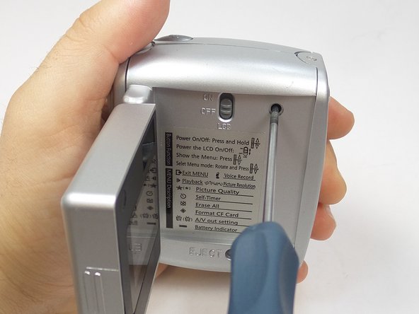

  2. Aiptek Pocket DVII 1.3M LCD  Memory Ejecting Assembly Replacement: step 2, image 1 of 1
    • Unscrew the three 4mm screws from the battery side of the device. Use a Phillips screw driver.

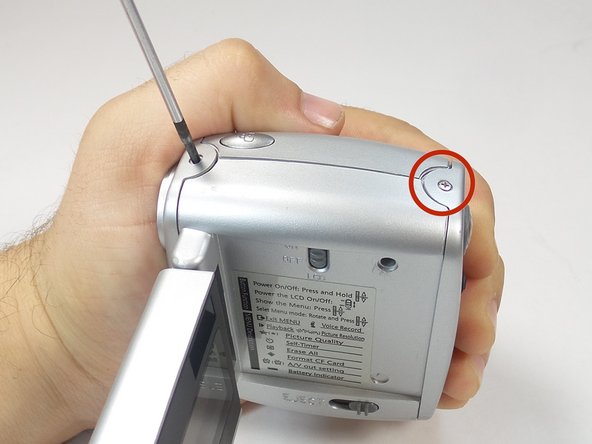

  4. Aiptek Pocket DVII 1.3M LCD  Memory Ejecting Assembly Replacement: step 4, image 1 of 2 Aiptek Pocket DVII 1.3M LCD  Memory Ejecting Assembly Replacement: step 4, image 2 of 2
    • Remove the sticky black dot.
    • Remove the hidden screw.

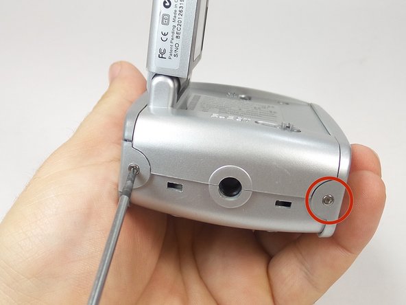

  5. Aiptek Pocket DVII 1.3M LCD  Memory Ejecting Assembly Replacement: step 5, image 1 of 2 Aiptek Pocket DVII 1.3M LCD  Memory Ejecting Assembly Replacement: step 5, image 2 of 2
    • Remove the two screws from the top side of the device.
    • Remove the two screws from the bottom side of the device.

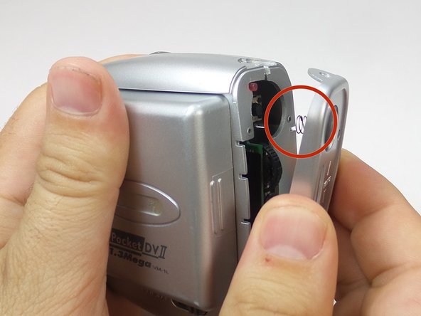

  6. Aiptek Pocket DVII 1.3M LCD  Memory Ejecting Assembly Replacement: step 6, image 1 of 1
    • Remove the rear cover.
    • Be careful not to lose the spring inside.

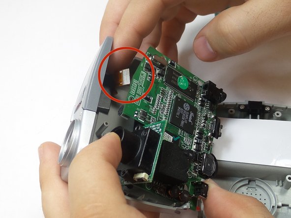

  10. Aiptek Pocket DVII 1.3M LCD  Memory Ejecting Assembly Replacement: step 10, image 1 of 1
    • Take out the motherboard while disconnecting the flip screen's cable from underneath.

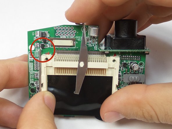

  13. Aiptek Pocket DVII 1.3M LCD  Memory Ejecting Assembly Replacement: step 13, image 1 of 1
    • Push the metal arm the button was on all the way up.
  14. Aiptek Pocket DVII 1.3M LCD  Memory Ejecting Assembly Replacement: step 14, image 1 of 2 Aiptek Pocket DVII 1.3M LCD  Memory Ejecting Assembly Replacement: step 14, image 2 of 2
    • Pop the main metal arm out of the other metal arm's socket.
    • Position the arm vertically like in the first picture. The arm should come off easily.
