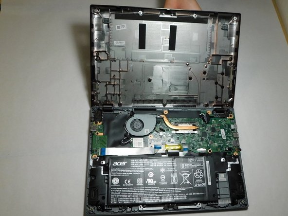

  4. Acer Chromebook CP5-471-C0EX Battery Replacement, Battery: step 4, image 1 of 2 Acer Chromebook CP5-471-C0EX Battery Replacement, Battery: step 4, image 2 of 2
    • Carefully detach the ribbon cable connecting the battery and the motherboard.
  5. Acer Chromebook CP5-471-C0EX Battery Replacement: step 5, image 1 of 1
    • Use your hands to lift the battery out of the device.
