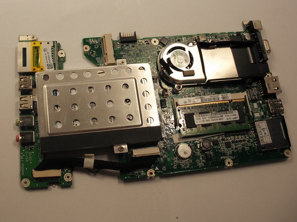

    6. Acer Aspire One ZG5 RAM Replacement: step 27, image 1 of 1
      • Lift the entire motherboard assembly out the case.
      Ask FixBot

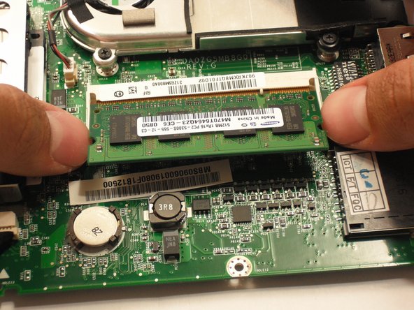

    1. Acer Aspire One ZG5 RAM Replacement, RAM: step 28, image 1 of 1
      • Turn the motherboard over so the RAM is facing up.
      Ask FixBot

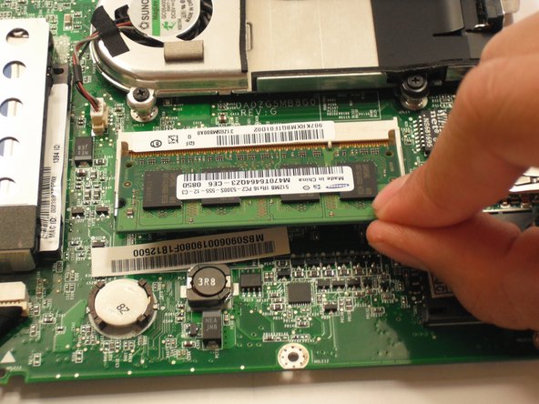

    2. Acer Aspire One ZG5 RAM Replacement: step 29, image 1 of 2 Acer Aspire One ZG5 RAM Replacement: step 29, image 2 of 2
      • Simultaneously release both latches on opposing sides of the RAM.
      • The RAM should spring up.
      Ask FixBot
    3. Acer Aspire One ZG5 RAM Replacement: step 30, image 1 of 1
      • Pull RAM straight out from the slot.
      Ask FixBot
