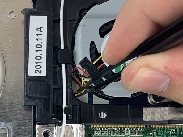

  4. Acer Aspire One D255-1625 Fan Replacement: step 4, image 1 of 3 Acer Aspire One D255-1625 Fan Replacement: step 4, image 2 of 3 Acer Aspire One D255-1625 Fan Replacement: step 4, image 3 of 3
    Tool used on this step:
    Buy
    • Use the tweezers to disconnect the fan's wires from laptop.
    • Use the Phillips #1 screwdriver to remove the three 4mm screws that hold the fan in place.
    • The 3rd screw on the bottom right is extremely difficult to remove as it requires you to bend the motherboard slightly in order to reach it.
