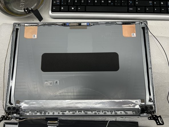

  3. Acer Aspire A315-58 LCD Screen Replacement, Screen replacement: step 3, image 1 of 3 Acer Aspire A315-58 LCD Screen Replacement, Screen replacement: step 3, image 2 of 3 Acer Aspire A315-58 LCD Screen Replacement, Screen replacement: step 3, image 3 of 3
    • Take out the screws and heat up the both edge of the screen where the adhesive tape at.
    • Replace the new tapes shown in the picture on both sides and reassemble the LCD back to the Cover.
