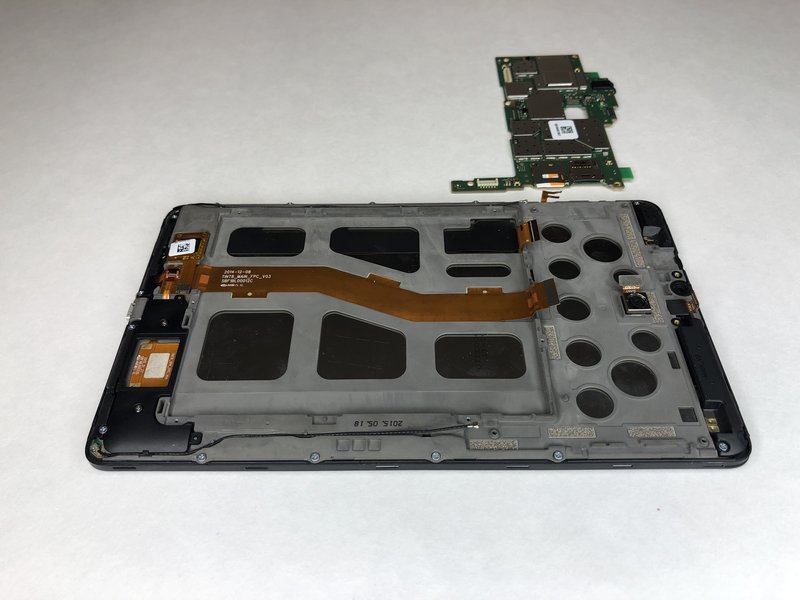

    1. ATT Trek HD Front Camera Replacement, Motherboard: step 5, image 1 of 2 ATT Trek HD Front Camera Replacement, Motherboard: step 5, image 2 of 2
      • Using a Phillips #00 screwdriver, remove the seven 1 mm screws on the green perimeter of the motherboard.
      Ask FixBot
    2. ATT Trek HD Front Camera Replacement: step 6, image 1 of 2 ATT Trek HD Front Camera Replacement: step 6, image 2 of 2
      • Use the plastic opening tool to disconnect the large gold strip underneath the metal plate from the motherboard.
      Ask FixBot
    3. ATT Trek HD Front Camera Replacement: step 7, image 1 of 1
      • Use the plastic opening tool to disconnect the front and back cameras from motherboard.
      Ask FixBot
    4. ATT Trek HD Front Camera Replacement: step 8, image 1 of 2 ATT Trek HD Front Camera Replacement: step 8, image 2 of 2
      Tool used on this step:
      $3.99
      Buy
      • Use angled tweezers to pry up the black tab.
      • Use the angled tweezers to pull out the gold connector.
      Ask FixBot
    5. ATT Trek HD Front Camera Replacement: step 9, image 1 of 2 ATT Trek HD Front Camera Replacement: step 9, image 2 of 2
      • Use the angled tweezers to disconnect the gold connector.
      Ask FixBot
    6. ATT Trek HD Front Camera Replacement: step 10, image 1 of 1
      • Use the plastic opening tool to disconnect the black connectors on each side of the motherboard.
      Ask FixBot
    7. ATT Trek HD Front Camera Replacement: step 11, image 1 of 2 ATT Trek HD Front Camera Replacement: step 11, image 2 of 2
      • Use the plastic opening tool to lift the motherboard out of place.
      Ask FixBot
