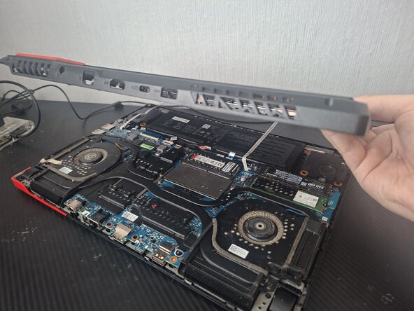

    5. ASUS ROG Strix G15 G513 RAM Replacement: step 5, image 1 of 3 ASUS ROG Strix G15 G513 RAM Replacement: step 5, image 2 of 3 ASUS ROG Strix G15 G513 RAM Replacement: step 5, image 3 of 3
      • Start by peeling from the bottom right corner slowly until the entire back cover comes off
      • Rotate your laptop
      • Beware of 2 thin LED ribbon cables that are still attached

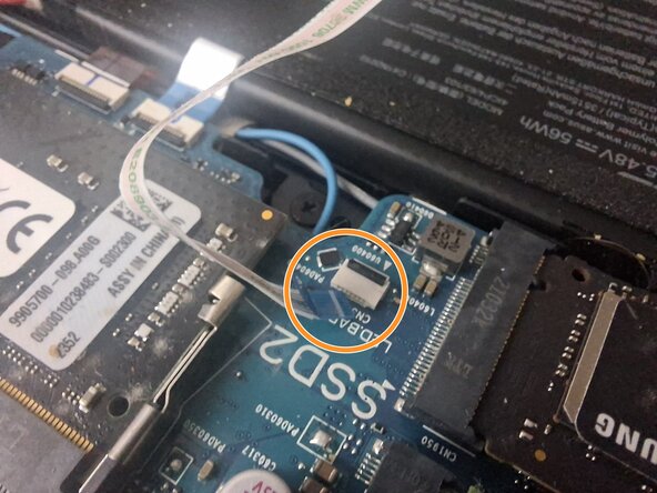

    6. ASUS ROG Strix G15 G513 RAM Replacement: step 6, image 1 of 3 ASUS ROG Strix G15 G513 RAM Replacement: step 6, image 2 of 3 ASUS ROG Strix G15 G513 RAM Replacement: step 6, image 3 of 3
      • Now you need to unplug them
      • Start by lifting the small black part of the connector up
      • Then just pull the cable away

    8. ASUS ROG Strix G15 G513 RAM Replacement: step 8, image 1 of 1
      • Now remove the back cover completely

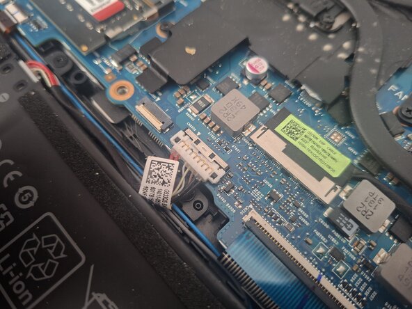

    9. ASUS ROG Strix G15 G513 RAM Replacement: step 9, image 1 of 3 ASUS ROG Strix G15 G513 RAM Replacement: step 9, image 2 of 3 ASUS ROG Strix G15 G513 RAM Replacement: step 9, image 3 of 3
      • Now you need to disconnect the battery
      • Locate the connector
      • Pull the top tin lock away from you as seen on image 1 vs 2
      • Then disconnect the battery connector by supporting it from sides and lifting it up

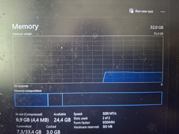

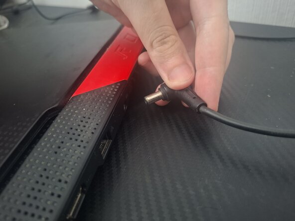

      • Now plug in your laptop
      • Power it on and check in BIOS or task manager if your RAM is set up correctly
      • Beware of Memory training (check out conclusion)

Hopefully your RAM replacement was successful, don't forget to double-check for example in BIOS or the Task manager -> Performance -> Memory tab. Also upon first boot with your new RAM a strange occurrence may happen where the laptop starts turning itself on and off while the screen stays black with no logo or anything repeatedly, don't worry this is called "memory training" the laptop is trying to figure out how much RAM it has, what frequency it runs at and what voltages it needs.... the best move is to let it be for 2 to 5 minutes. If it is taking longer than 5 minutes try doing a hard reset by holding down the power button until the laptop turns off and then manually turn it on again.
