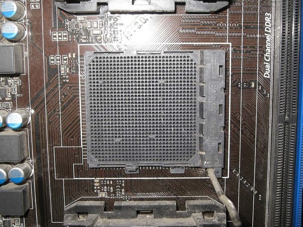

    • The Processor socket is a ZIF socket. '''Z'''ero '''I'''nsertion '''F'''orce. There should be no time when you have to apply any pressure or force when removing or inserting a processor!
    • To remove the processor on an AM3+ board gently push the leave on the socket way from under it's retaining clip and lift it up into a vertical position. If the machine is a tower chances are the processor will drop out.
    • Put the old processor into an anti-static container, Ensure your anti-static strap is connected. Remove the new processor from its anti-static container and gently place it in the socket. Both the processor and socket are marked as shown with a triangle to show the processor orientation.
    • If the processor does not drop into the socket cleanly invert it and ensure all of the pins are straight. If they are not box it up and return it if you can. Straighten processor pins is difficult and they can easily break.
