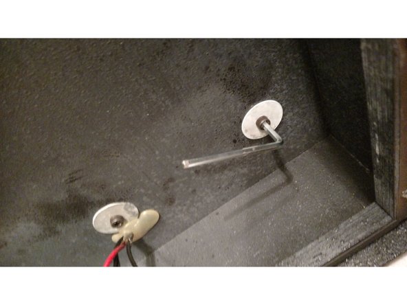

    4. AER Compact Mobile (US Version) Rechargeable Battery Replacement, Get the Locks of the Battery holder off: step 4, image 1 of 3 AER Compact Mobile (US Version) Rechargeable Battery Replacement, Get the Locks of the Battery holder off: step 4, image 2 of 3 AER Compact Mobile (US Version) Rechargeable Battery Replacement, Get the Locks of the Battery holder off: step 4, image 3 of 3
      • You can (hopefully) see the size 8 locks on top of the long distance holders the come from the back of the chamber.
      • Those need to come off, but only for the part that secures the black batteries on the top, very much right behind the speaker.
      • Since it is virtually impossible to remove the locks without removing the speaker, speaker needs to come off. Another four very well fitted Philips screws that need to come off around the front side of the speaker.
      • Please find a picture attached for the tool I found in my treasure tool chest. Brought it from Germany.. "It's because of the metric system, you know.."

    6. AER Compact Mobile (US Version) Rechargeable Battery Replacement, The back panel: step 6, image 1 of 3 AER Compact Mobile (US Version) Rechargeable Battery Replacement, The back panel: step 6, image 2 of 3 AER Compact Mobile (US Version) Rechargeable Battery Replacement, The back panel: step 6, image 3 of 3
      • The back panel with all electronics has come off nicely.
      • As you can see, there is four screws on the black back of the speaker compartment which you need to attack in a later step.
      • I am showing it here so that you can prepare the tool, it is not yet time to take them out. First, we have to remove the carrying handle and the from grille as well as the speaker.
      • Please make sure you get a tool that helps you (In german this would be an 'Imbus', a small one)

    7. AER Compact Mobile (US Version) Rechargeable Battery Replacement, Unscrew the Battery Holder Long Distance Holders: step 7, image 1 of 3 AER Compact Mobile (US Version) Rechargeable Battery Replacement, Unscrew the Battery Holder Long Distance Holders: step 7, image 2 of 3 AER Compact Mobile (US Version) Rechargeable Battery Replacement, Unscrew the Battery Holder Long Distance Holders: step 7, image 3 of 3
      • To get the light color wood battery holders off and to finally take the batteries out, you need to unscrew the top three of the long distance holders that are accessible from the outer back of the speaker chamber.
      • Please remember that in a prior step, the counter locks have been removed, so those should come out easily.
