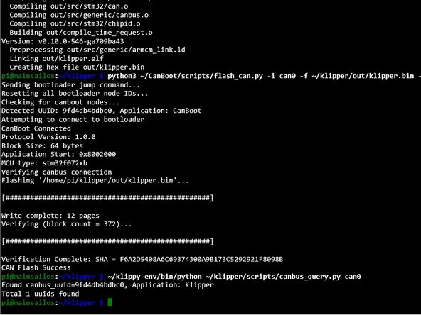

      • flash the EBB36 with the newly compiled firmware
      • python3 ~/CanBoot/scripts/flash_can.py -i can0 -f ~/klipper/out/klipper.bin -u 9fd4db4bdbc0
      • sudo dfu-util -a 0 -d 0483:df11 --dfuse-address 0x08000000 -D ~/CanBoot/out/canboot.bin
      • If all goes well your CAN board should now be flashed
      • run
      • ~/klippy-env/bin/python ~/klipper/scripts/canbus_query.py can0
      • Load the provided files to the printer and press FIRMWARE_RESTART
      • Checking the Machine tab you should see the 4 systems
