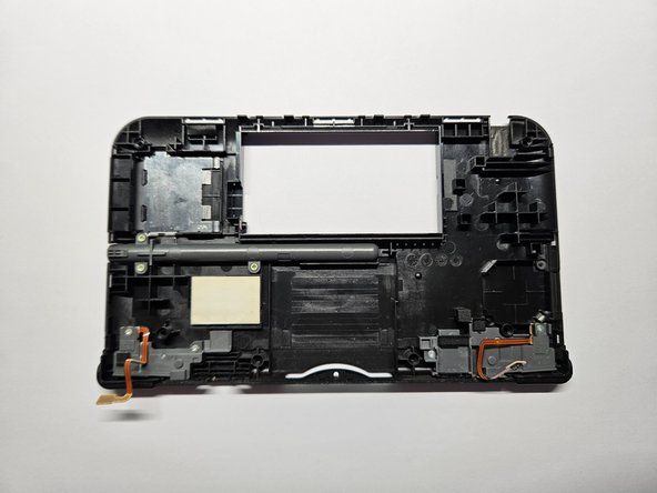

  8. 3DS XL SD Card Cover Replacement, Replacing SD Cover: step 8, image 1 of 2 3DS XL SD Card Cover Replacement, Replacing SD Cover: step 8, image 2 of 2
    • Remove the 3 golden, 2.3 mm screws located around the stylus slot with a Phillips #00 screwdriver.

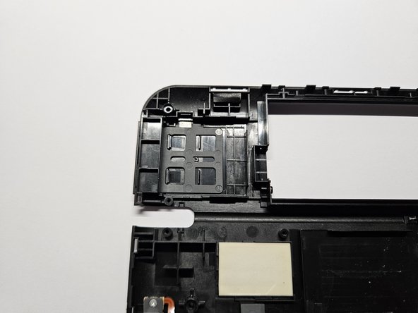

  9. 3DS XL SD Card Cover Replacement: step 9, image 1 of 2 3DS XL SD Card Cover Replacement: step 9, image 2 of 2
    • Using a pry tool, lift up the thin metal plate above the SD Card Cover.
  10. 3DS XL SD Card Cover Replacement: step 10, image 1 of 2 3DS XL SD Card Cover Replacement: step 10, image 2 of 2
    • Slightly bend the silicone (Light Gray) part and pull the cover out of the device.
