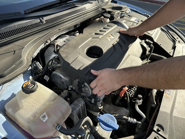

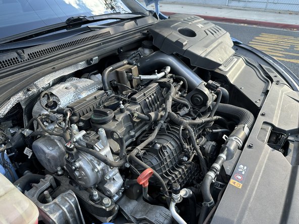

  4. 2021 Hyundai Veloster Spark Plug Replacement: step 4, image 1 of 3 2021 Hyundai Veloster Spark Plug Replacement: step 4, image 2 of 3 2021 Hyundai Veloster Spark Plug Replacement: step 4, image 3 of 3
    • Carefully detach the engine cover with your hands and set it aside.

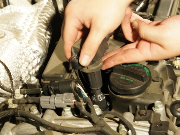

  5. 2021 Hyundai Veloster Spark Plug Replacement: step 5, image 1 of 3 2021 Hyundai Veloster Spark Plug Replacement: step 5, image 2 of 3 2021 Hyundai Veloster Spark Plug Replacement: step 5, image 3 of 3
    • Identify the spark plugs on top of the engine.
    • Remove the bolts securing the spark plugs using a 10 mm socket, extension, and wrench.
    • Gently pull out the spark plug wires.
    • Exercise care when pulling out the spark plug wires to prevent dislodging any dirt or contaminants that may fall into the engine.

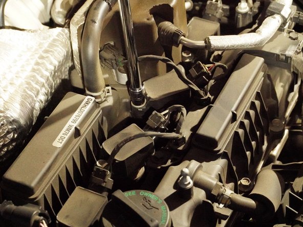

  6. 2021 Hyundai Veloster Spark Plug Replacement: step 6, image 1 of 3 2021 Hyundai Veloster Spark Plug Replacement: step 6, image 2 of 3 2021 Hyundai Veloster Spark Plug Replacement: step 6, image 3 of 3
    • Utilize a spark plug socket, extension, and wrench to carefully remove all four spark plugs.

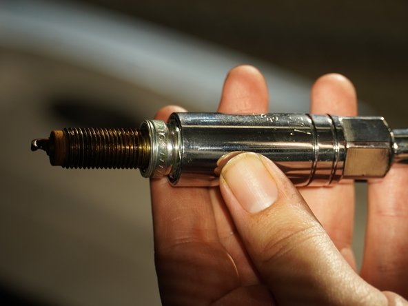

  7. 2021 Hyundai Veloster Spark Plug Replacement: step 7, image 1 of 1
    • Verify the proper factory gap on the new spark plugs using a Spark Plug Gap Gauge.
    • Gap range: .022mm-.028mm
  8. 2021 Hyundai Veloster Spark Plug Replacement: step 8, image 1 of 1
    • Place a new spark plug into the spark plug socket.
    • Torque each spark plug to 18 ft-lbs.
