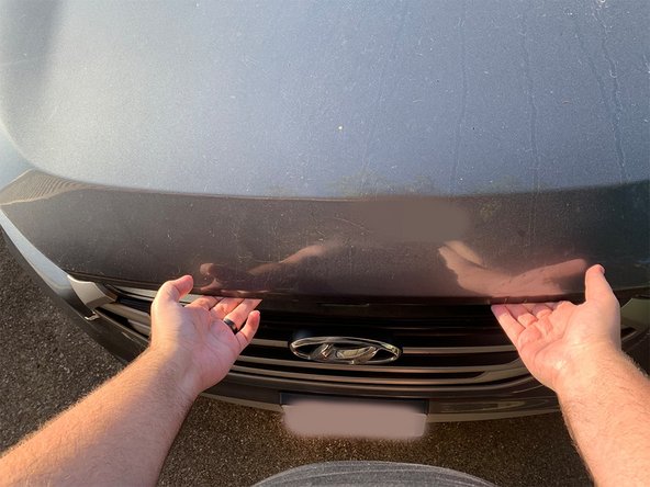

    • Ensure your vehicle is turned off.
    • Do not touch the new lightbulb with your hands. The oil on your hands can damage the bulb and cause it to fail prematurely.
    • Inside the driver’s side of the vehicle, pull the hood latch to unlock the hood.
    • Open the hood.
    • Secure the hood using the hood support rod.

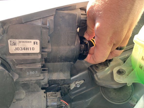

  4. 2018 Hyundai Tucson Low Beam Headlight Bulb Replacement: step 4, image 1 of 1
    • Reach into the low-beam headlight assembly, and then grab the headlight housing.
    • Twist the headlight housing counterclockwise to unlock it.

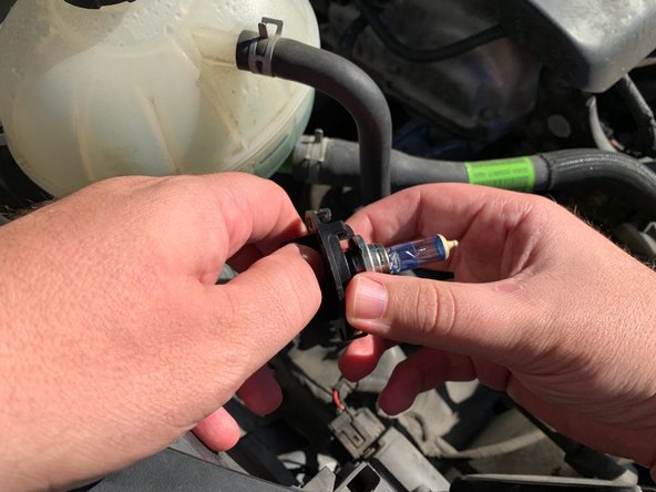

  5. 2018 Hyundai Tucson Low Beam Headlight Bulb Replacement: step 5, image 1 of 3 2018 Hyundai Tucson Low Beam Headlight Bulb Replacement: step 5, image 2 of 3 2018 Hyundai Tucson Low Beam Headlight Bulb Replacement: step 5, image 3 of 3
    • Pull out the headlight housing from the headlight assembly.
    • Grab the lightbulb and then pull it out from the headlight housing.

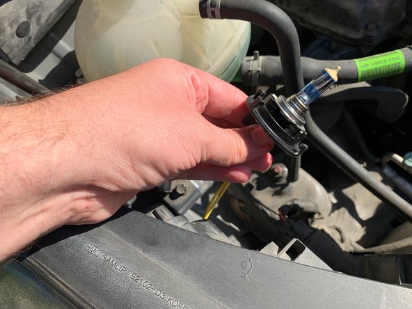

  6. 2018 Hyundai Tucson Low Beam Headlight Bulb Replacement: step 6, image 1 of 3 2018 Hyundai Tucson Low Beam Headlight Bulb Replacement: step 6, image 2 of 3 2018 Hyundai Tucson Low Beam Headlight Bulb Replacement: step 6, image 3 of 3
    • Open the package of the new lightbulb.
    • Grab the lightbulb by the base.
    • Attach the new lightbulb to the headlight housing.
