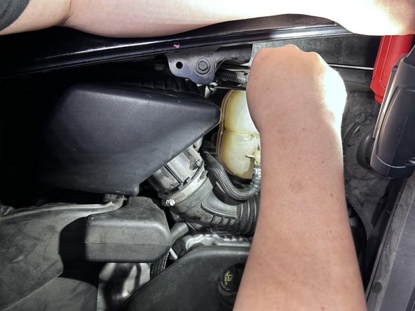

  2. 2017 Jeep Cherokee Air Filter Replacement: step 2, image 1 of 2 2017 Jeep Cherokee Air Filter Replacement: step 2, image 2 of 2
    • The engine air filter housing is a rectangular, black plastic box situated near the front left of the engine bay (if you are facing the engine bay).

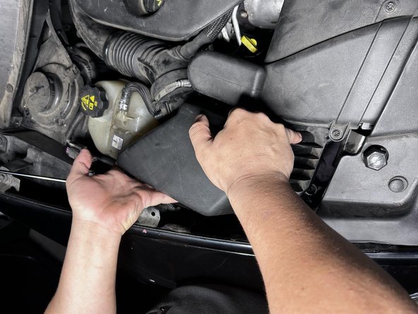

  3. 2017 Jeep Cherokee Air Filter Replacement: step 3, image 1 of 3 2017 Jeep Cherokee Air Filter Replacement: step 3, image 2 of 3 2017 Jeep Cherokee Air Filter Replacement: step 3, image 3 of 3
    • Ensure the engine has cooled down to avoid the risk of burns.
    • Use a Phillips #2 screwdriver to remove the three 8 mm screws securing the air filter housing cover.
    • There are two screws located at the front of the housing and one at the back.
    • Carefully set each screw aside in a safe spot to prevent them from rolling away or getting lost.
  4. 2017 Jeep Cherokee Air Filter Replacement: step 4, image 1 of 3 2017 Jeep Cherokee Air Filter Replacement: step 4, image 2 of 3 2017 Jeep Cherokee Air Filter Replacement: step 4, image 3 of 3
    • Lift the cover off the air filter housing.
    • Observe how the old air filter sits inside the housing to ensure correct orientation when installing the new filter.
    • Remove the old air filter by lifting it straight out of the housing.
    • Inspect it for excessive dirt and debris to determine the filter's condition.
    • Handle the old filter carefully to avoid dispersing accumulated dirt.
