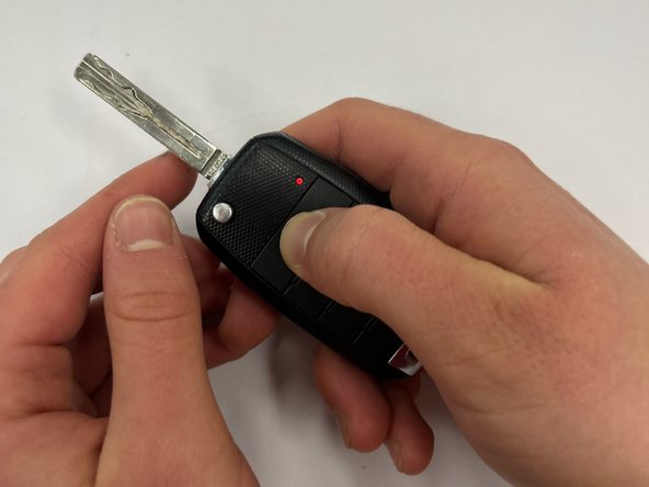

    2. 2015 KIA Optima Key Fob Battery Replacement: step 2, image 1 of 2 2015 KIA Optima Key Fob Battery Replacement: step 2, image 2 of 2
      • Pull out the metal key.

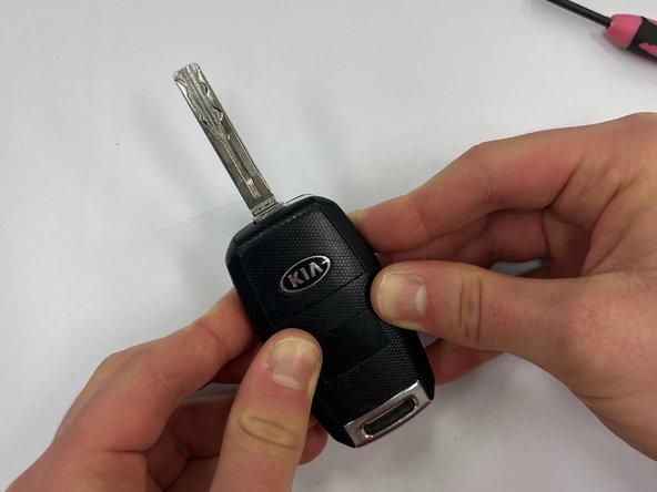

    3. 2015 KIA Optima Key Fob Battery Replacement: step 3, image 1 of 3 2015 KIA Optima Key Fob Battery Replacement: step 3, image 2 of 3 2015 KIA Optima Key Fob Battery Replacement: step 3, image 3 of 3
      • Use a small flathead screwdriver to pry open the case and separate the two halves.

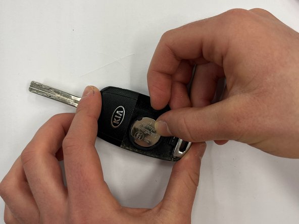

    4. 2015 KIA Optima Key Fob Battery Replacement: step 4, image 1 of 3 2015 KIA Optima Key Fob Battery Replacement: step 4, image 2 of 3 2015 KIA Optima Key Fob Battery Replacement: step 4, image 3 of 3
      • Remove the old battery with the small flathead screwdriver.

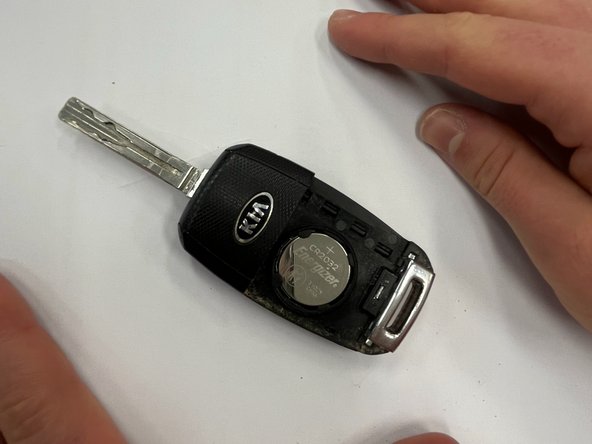

    5. 2015 KIA Optima Key Fob Battery Replacement: step 5, image 1 of 3 2015 KIA Optima Key Fob Battery Replacement: step 5, image 2 of 3 2015 KIA Optima Key Fob Battery Replacement: step 5, image 3 of 3
      • Insert the new CR2032 3 volt battery.
      • Make sure the “+” (positive) side faces up.
