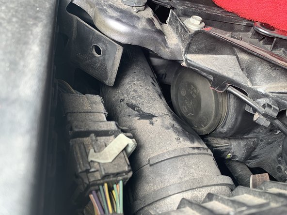

    5. 2012 Ford Fusion Headlight Replacement: step 5, image 1 of 2 2012 Ford Fusion Headlight Replacement: step 5, image 2 of 2
      • Locate the headlight bulb in the front of the car under the hood and twist off the cap covering the headlight bulb
      Ask FixBot

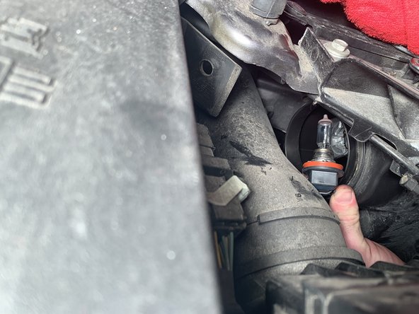

    6. 2012 Ford Fusion Headlight Replacement: step 6, image 1 of 2 2012 Ford Fusion Headlight Replacement: step 6, image 2 of 2
      • twist the housing to the light bulb and pull it out
      Ask FixBot
    7. 2012 Ford Fusion Headlight Replacement: step 7, image 1 of 2 2012 Ford Fusion Headlight Replacement: step 7, image 2 of 2
      • unclip the light bulb from the housing latch and replace light bulb
      Ask FixBot
