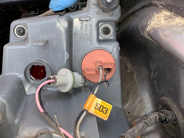

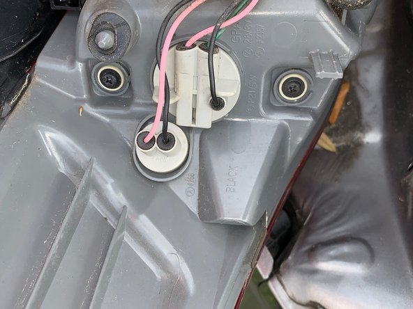

    • Once the bolts are removed, you will need to remove the wires connected to the bulb casing. Firmly push in on the center piece at the base of the wire and pull directly out to remove.

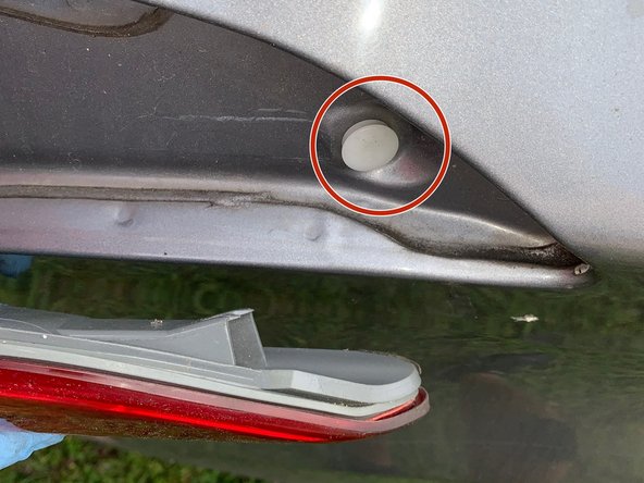

    • Once the wires are disconnected facing the bumper, firmly grasp the entire plastic casing of the tail light and pull directly towards your hips in order to not catch the hidden clip located on the side of the car near the end of the tail light casing.

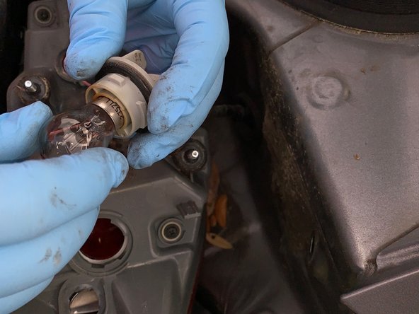

    • In order to remove the main brake/tail light, remove small light first. This is the same process for the main light. Using pliers grip the plastic and pull while rotating counterclockwise 30 degrees and remove the bulb from the socket.
    • Repeat this step to remove main bulb as well.
  6. 2011 Hyundai Elantra Tail Light Replacement: step 6, image 1 of 2 2011 Hyundai Elantra Tail Light Replacement: step 6, image 2 of 2
    • Put a new Sylvania long life bulb into the socket until you hear it click.

    • After you seal the bulb, you will then place the entire casing back into the bumper ensuring that the hidden clip mentioned earlier is attached. Then, re attach the wires, you should hear a clicking sound when wire is properly placed in socket.
