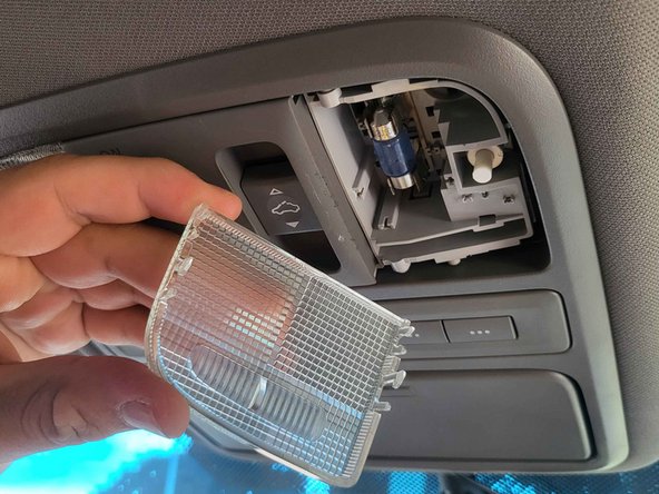

    • Use a plastic pry tool to detach the light cover.
    • Be careful not to pry too hard, otherwise you risk breaking the cover.

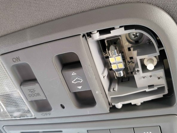

  2. 2011 Honda Pilot Overhead Lightbulb and Switch Replacement: step 2, image 1 of 3 2011 Honda Pilot Overhead Lightbulb and Switch Replacement: step 2, image 2 of 3 2011 Honda Pilot Overhead Lightbulb and Switch Replacement: step 2, image 3 of 3
    • Use the pry tool to the light and attach the new one inside of the clamps that hold the bulb.
    • Repeat the same process for the left side bulb.

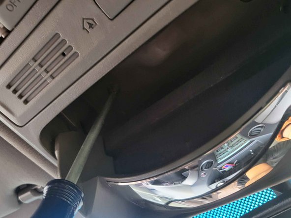

    • Remove the screws inside of the unit using a Phillips #00 screwdriver.
  4. 2011 Honda Pilot Overhead Lightbulb and Switch Replacement: step 4, image 1 of 3 2011 Honda Pilot Overhead Lightbulb and Switch Replacement: step 4, image 2 of 3 2011 Honda Pilot Overhead Lightbulb and Switch Replacement: step 4, image 3 of 3
    • Open the sunglasses case.
    • Use a Phillips #00 screwdriver to remove the screws.
    • Keep track of the screws. The front ones are silver, while the black ones inside the sunglasses case are black.

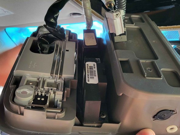

  5. 2011 Honda Pilot Overhead Lightbulb and Switch Replacement: step 5, image 1 of 1
    • After the screws come undone, this is what the unit should look like.

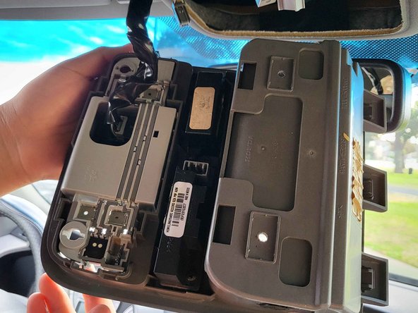

  7. 2011 Honda Pilot Overhead Lightbulb and Switch Replacement: step 7, image 1 of 1
    • After detaching all cables, the unit should look like this and come right off.
