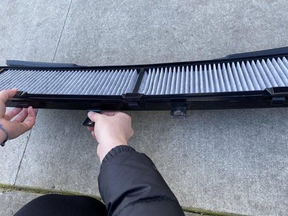

This guide provides instructions on how to change your BMW Series 3 cabin air filter. Cabin air filters usually need replacement within 15,000 - 30,000 miles. An unchanged air filter is harmful to one's health so it is important to replace.
This repair requires a filter with dimensions 32.8in x 6.18in x 1.1in. The size of the cabin air filter varies between car models. Be sure to check your car model for the correct filter size.
