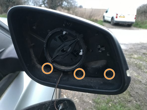

Replacing LED unit in BMW wing mirrors which functions as an 'auxiliary' turn signal (in addition to the main indicator lamps).
Gently use a car trim tool to pop the mirror glass off its central holder. You shouldn't need to detach the cables to it, as it can just rest against the window after removal.
To reassemble, follow these instructions in reverse order.
