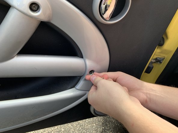

      • Roll down the window.
      • Remove the 3 exposed screws on the plastic door panel using the Phillips #3 Screwdriver.

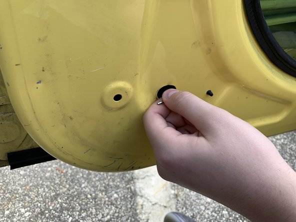

    2. 2004 Mini Cooper Driver Window Replacement: step 2, image 1 of 2 2004 Mini Cooper Driver Window Replacement: step 2, image 2 of 2
      • Remove the red reflector at the top edge of the door panel using a flathead screwdriver.
      • Unscrew the screw beneath the reflector using the 5/32 Allen key.

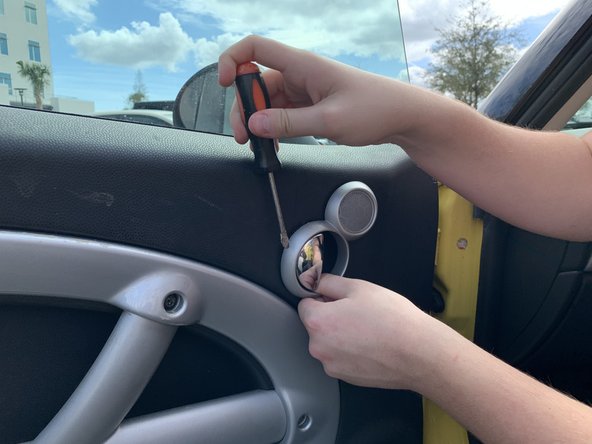

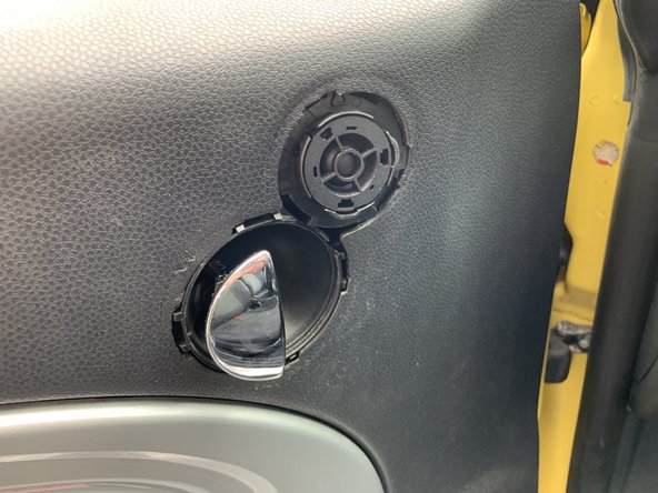

    3. 2004 Mini Cooper Driver Window Replacement: step 3, image 1 of 3 2004 Mini Cooper Driver Window Replacement: step 3, image 2 of 3 2004 Mini Cooper Driver Window Replacement: step 3, image 3 of 3
      • Remove the handle and speaker cover using a flathead screwdriver.
      • Be careful not to pry with too much force, as this may cause the plastic to crack.

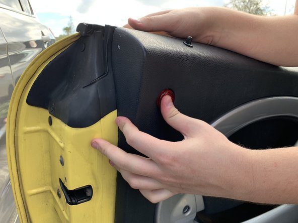

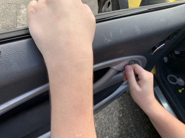

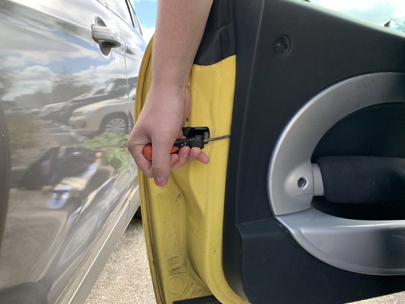

    4. 2004 Mini Cooper Driver Window Replacement: step 4, image 1 of 3 2004 Mini Cooper Driver Window Replacement: step 4, image 2 of 3 2004 Mini Cooper Driver Window Replacement: step 4, image 3 of 3
      • Wedge the door open with a flathead screwdriver and be careful with the locking mechanism when removing the panel.
      • Once the door panel has been popped off, use both hands and set it aside carefully.

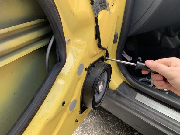

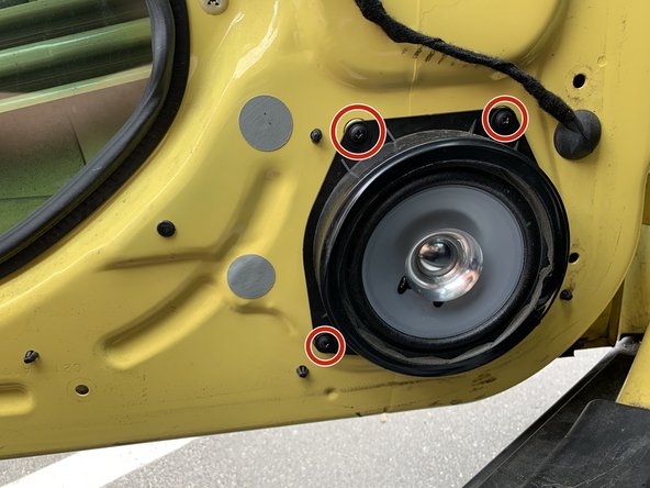

    5. 2004 Mini Cooper Driver Window Replacement: step 5, image 1 of 3 2004 Mini Cooper Driver Window Replacement: step 5, image 2 of 3 2004 Mini Cooper Driver Window Replacement: step 5, image 3 of 3
      • Remove the 3 screws holding the speaker in place using the Phillips #3 screwdriver.
      • On the final screw, hold the speaker part with one hand to make sure it does not fall off onto a hard surface and get damaged.
      • Lift the speaker out and set it nearby, being careful not to pull excessively on the wire connected to it.
      • It may be useful to set the speaker within the cabin, or to place it on a box beside the door panel, but it will all depend on how long the speaker cable is.

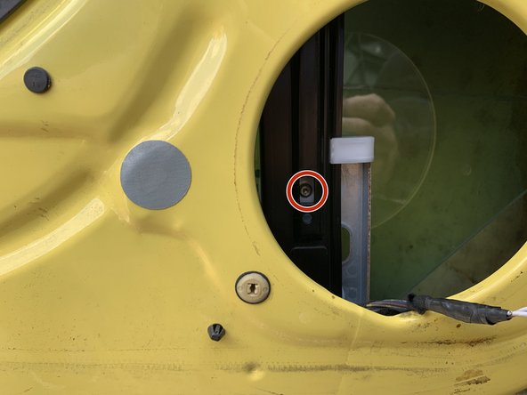

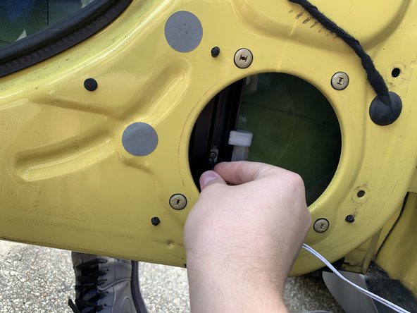

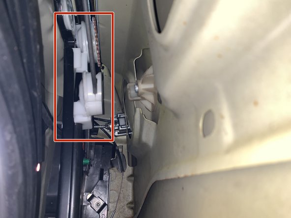

    6. 2004 Mini Cooper Driver Window Replacement: step 6, image 1 of 3 2004 Mini Cooper Driver Window Replacement: step 6, image 2 of 3 2004 Mini Cooper Driver Window Replacement: step 6, image 3 of 3
      • Remove two screws, one in the bottom-left corner of the door panel and the other in the speaker hole, with a 5/32 Allen key.
      • These screws will loosen the rollers that hold the window in place.
