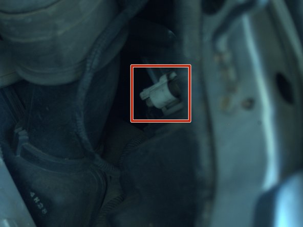

  6. 2003-2007 Honda Accord Headlight Bulb Replacement: step 6, image 1 of 2 2003-2007 Honda Accord Headlight Bulb Replacement: step 6, image 2 of 2
    • I attempted to highlight the location of the plug for the bulb as best as possible, so you can at least know what area we are attempting to access.
    • The bright white object is the plug.

  9. 2003-2007 Honda Accord Headlight Bulb Replacement: step 9, image 1 of 3 2003-2007 Honda Accord Headlight Bulb Replacement: step 9, image 2 of 3 2003-2007 Honda Accord Headlight Bulb Replacement: step 9, image 3 of 3
    • Grab the plug and twist it counterclockwise to loosen it. It should pop out fairly easily.
    • If it does not come out easily, do not force it. The plastic will break.
    • Attempt to spray the compressed air in the area of the plug. Sprayed in the crevice where it turns, this should allow it to move easier.
