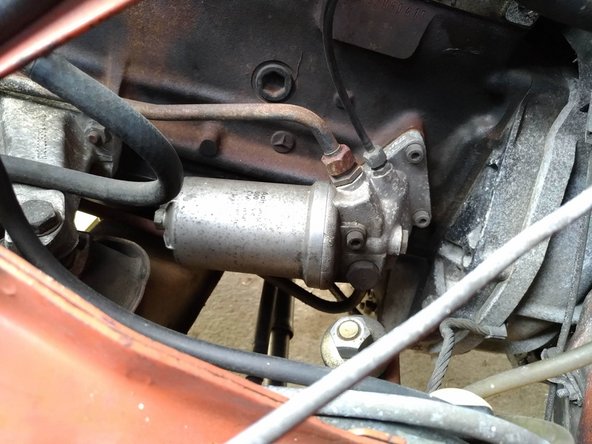

  4. 1976 Mercedes-Benz 230.6  Oil and filter, Remove old filter: step 5, image 1 of 3 1976 Mercedes-Benz 230.6  Oil and filter, Remove old filter: step 5, image 2 of 3 1976 Mercedes-Benz 230.6  Oil and filter, Remove old filter: step 5, image 3 of 3
    • Check your new filter etc, I used Hengst E117H D07, but last time I used Mann H720X, both kits came with new o-rings and copper crush-washers
    • The oil filter is a cartridge-in-housing type located on the left-side of the engine block
    • I only had room for a wrench/spanner and had to work it a bit before loosening it with my fingers
