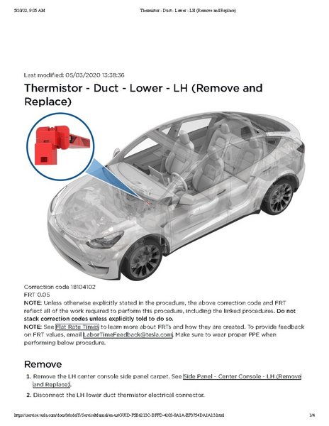

Last modified: 05/03/2020 13:38:36
Thermistor - Duct - Lower - LH (Remove and Replace)
NOTE: Unless otherwise explicitly stated in the procedure, the above correction code and FRT reflect all of the work required to perform this procedure, including the linked procedures. Do not stack correction codes unless explicitly told to do so.
NOTE: See to learn more about FRTs and how they are created. To provide feedback on FRT values, email . Make sure to wear proper PPE when performing below procedure. Flat Rate Times LaborTimeFeedback@tesla.com
Remove
  • Remove the LH center console side panel carpet. See . Side Panel - Center Console - LH (Remove and Replace)
  • Disconnect the LH lower duct thermistor electrical connector.
  • Release the clips that attach the LH lower duct thermistor to the HVAC assembly, and then pull the LH lower duct thermistor straight out from the HVAC assembly.
Install
  • Push the LH lower duct thermistor into the HVAC assembly until the retaining clips are fully secure.
  • Connect the LH lower duct thermistor electrical connector.
  • Install the LH center console side panel carpet. See . Side Panel - Center Console - LH (Remove and Replace)
