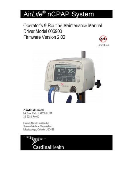

Air Life ® nCPAP System
Operator's & Routine Maintenance Manual
Driver Model 006900 Firmware Version 2.02
Latex Free
Cardinal Health McGaw Park, IL 60085 USA
36-5031 Rev D
Distributed in Canada by Source Medical Corporation Mississauga, Ontario L4Z 4B9
