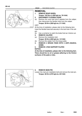

REMOVAL
  1. REMOVE REAR WHEEL
Torque: 103 N·m (1.050 kgf·cm, 76 ft·lbf)
  1. DISCONNECT FLEXIBLE HOSE
  2. (a) Remove the union bolt and 2 gaskets from the caliper, then disconnect the flexible hose from the caliper.
Torque: 29 N·m (300 kgf·cm, 21 ft·lbf)
HINT:
At the time of installation, please refer to the following it Insert the flexible hose lock securely in the lock hole in the per.
  • (b) Use a container to catch the brake fluid as it drains o
  1. REMOVE CALIPER
  • (a) Remove the installation bolt.
Torque: 20 N·m (200 kgf·cm, 14 ft·lbf)
  • (b) Remove the caliper from the torque plate.
  1. REMOVE 2 BRAKE PADS WITH 4 ANTI-SQUEAL SHIMS
  2. REMOVE 4 PAD SUPPORT PLATES
NOTICE:
At the time of installation, please refer to the following item There should be no oil or grease adhering to the friction surfaces of the pads or disc.
  1. REMOVE MAIN PIN
Loosen the main pin installation bolt and remove the main pin.
Torque: 26 N·m (270 kgf·cm, 20 ft·lbf)
