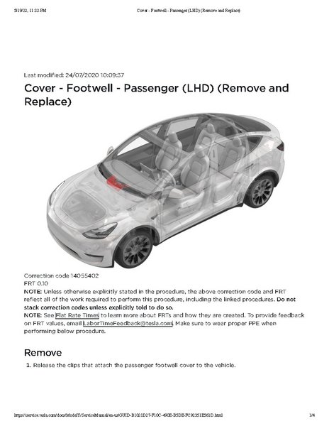

Last modified: 24/07/2020 10:09:37
Cover - Footwell - Passenger (LHD) (Remove and Replace)
Correction code 14055402
FRT 0.10
NOTE: Unless otherwise explicitly stated in the procedure, the above correction code and FRT reflect all of the work required to perform this procedure, including the linked procedures. Do not stack correction codes unless explicitly told to do so.
NOTE: See to learn more about FRTs and how they are created. To provide feedback on FRT values, email . Make sure to wear proper PPE when performing below procedure. Flat Rate Times LaborTimeFeedback@tesla.com
Remove
  • Release the clips that attach the passenger footwell cover to the vehicle.
  • Disconnect the electrical wiring harness connectors from the puddle light and emergency speaker.
  • Remove the footwell cover from the vehicle.
  • Release the clips that attach the puddle light to the passenger footwell cover, and then remove the puddle light from the footwell cover.
Install
Installation procedure is the reverse of removal.
