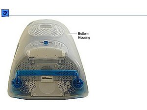

  • Thermal Management: The M5521 chassis was uniquely engineered to run without an internal cooling fan. It utilized convective cooling (drawing cold air from the bottom mesh slots and venting hot air out the integrated top handle), making the computer completely silent during operation save for the spin of the hard drive.
