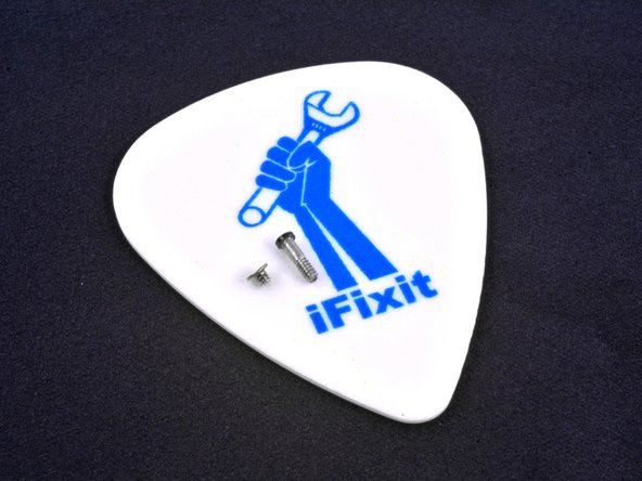

  5. iPad Mini Wi-Fi Teardown: step 6, image 1 of 3 iPad Mini Wi-Fi Teardown: step 6, image 2 of 3 iPad Mini Wi-Fi Teardown: step 6, image 3 of 3
    • So far it looks like Apple has more tricks than treats for us with a hidden screw securing the display.
    • After dispatching two hidden screws and two exposed screws with our 54 Bit Driver Kit, we are able to lift the LCD.
    • Pulling up the display reveals a large metal plate, held in with no fewer than 16 screws.
    • We found similar plates in the iPod Touch 5th Generation, and the iPhone 5, so this seems to be a new iDevice design convention.

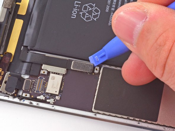

    • Our first exposed IC is one we've seen before, in the iPhone 5.
    • In fact, you might say we've got a pretty close relationship with the Murata 339S0171 Wi-Fi module.

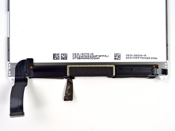

    • More tricks, fewer treats! With plastic opening tool in hand, we disconnect the display connector, but there's still something holding the LCD in…
  8. iPad Mini Wi-Fi Teardown: step 9, image 1 of 2 iPad Mini Wi-Fi Teardown: step 9, image 2 of 2
    • …and the culprit is found. Insulating tape holds the display to the rear case and protects the Lightning connector cable.
    • With the tape peeled up, we remove the display assembly and can turn our attention to the interior.

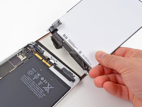

    • Bad news: due to the placement of connectors, you'll need to remove the LCD prior to removing the digitizer. Great news: the LCD and front glass are two separate components. This contrasts the fused glass-LCD assemblies in both the Kindle Fire HD and Nexus 7. Thanks for the repairability, Apple!

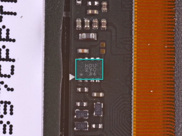

  9. iPad Mini Wi-Fi Teardown: step 10, image 1 of 3 iPad Mini Wi-Fi Teardown: step 10, image 2 of 3 iPad Mini Wi-Fi Teardown: step 10, image 3 of 3
    • Peeling the tape and EMI shield off the display reveals the ICs controlling the 1024x768 unit:
    • Samsung W1235 S6TNMR1X01 Display Driver
    • Silicon Mitus SM4031 DA1232 SMCP043, Display PMIC
    • 416R 8227
    • HDU 2YC 34
    • Though the markings on the back of the LCD don't turn up much information, the Samsung display driver IC reveals that Apple once again went with Samsung in its display manufacturing.
    • Apple has reportedly been working to move away from Samsung as a primary supplier, so it's somewhat surprising to see a Samsung LCD inside. With that said, Apple often relies on multiple suppliers for a single component, meaning there's quite likely other LCD manufacturers lurking inside other iPad Minis.

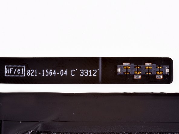

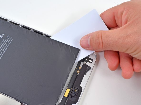

    • Fortunately, the iPad Mini inherited the connector-fastened battery from its larger sibling, not the soldered-in battery found in the iPod Touch.
    • A plastic card makes a nice tool to pry the battery up from the rear panel, but it's still a very difficult task to break through all of the adhesive securing it to the rear case without puncturing the cells.
    • A close-up of the battery connector exposes the numbers 821-1564-04 C 3312.

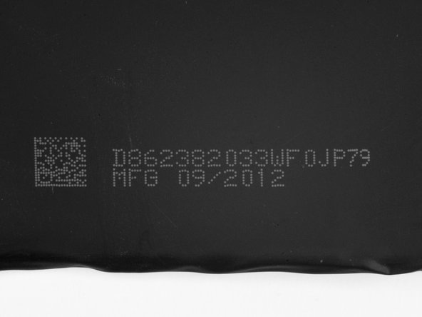

    • We get a good look at the battery, and find ourselves scratching our heads a bit.
    • This is a 3.72 V, 16.5 Whr, 4440 mAh battery.
    • Or maybe it's a 3.78 V, 16.9 Whr, 4400 mAh battery?
    • Or maybe it's a 3.72 V, 4400 mAh battery?
    • Or maybe, according to Apple's tech specs, it's only 16.3 Whr.
    • Whatever the capacity, it's decidedly mini when compared to the massive 43 Whr battery in the iPad 3. Even the venerable iPad 2 sports a 25 Whr package, 50% more than the iPad Mini.

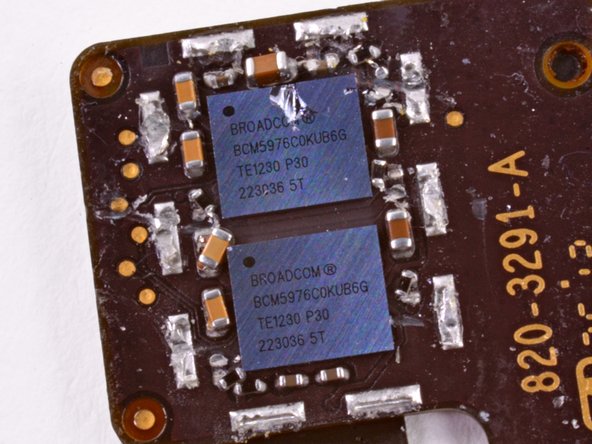

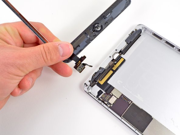

    • Next off is the digitizer.
    • Hiding on the connector are a couple of Broadcom touch controller ICs marked BCM5976C0KUB6G.
    • This chip looks familiar…oh yeah, we saw them in the MacBook Air.

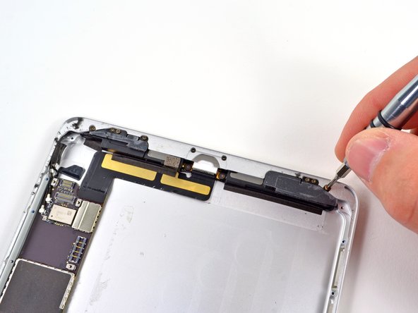

  13. iPad Mini Wi-Fi Teardown: step 14, image 1 of 3 iPad Mini Wi-Fi Teardown: step 14, image 2 of 3 iPad Mini Wi-Fi Teardown: step 14, image 3 of 3
    • An antenna sits on top of each speaker, presumably Wi-Fi and Bluetooth.
    • Apple wasn't joking about "mini"; these are some of the smallest screws we have ever seen!
    • For comparison, the screw on the right is from the bottom of an iPhone 5, where the screw on the left is from the Mini.

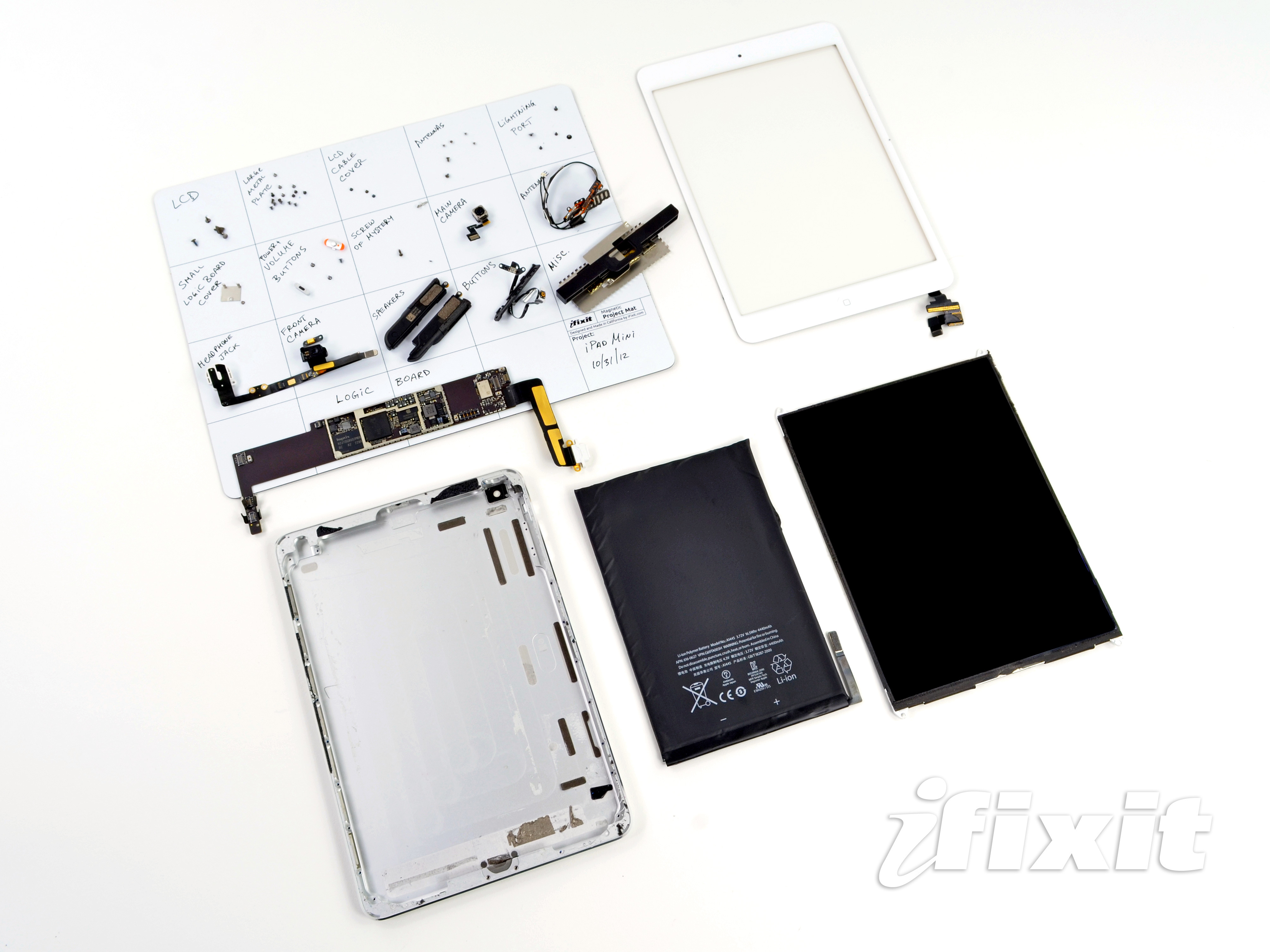

    • iPad Mini Repairability: 2 out of 10 (10 is easiest to repair).
    • The LCD and glass are not fused together and can be replaced independently.
    • The battery is not soldered to the logic board or other components.
    • Teeny-tiny screws can be easily misplaced if you're not careful. Don't sneeze too hard while taking them off.
    • Copious amounts of adhesive hold many components in place -- front glass, logic board, battery, front camera, back camera, ribbon cables -- making repair extremely difficult.
    • The Lightning connector is soldered to the logic board, so don't bend its pins.
    • Hidden screws mean you'll need to be very diligent when trying to remove internal components.
