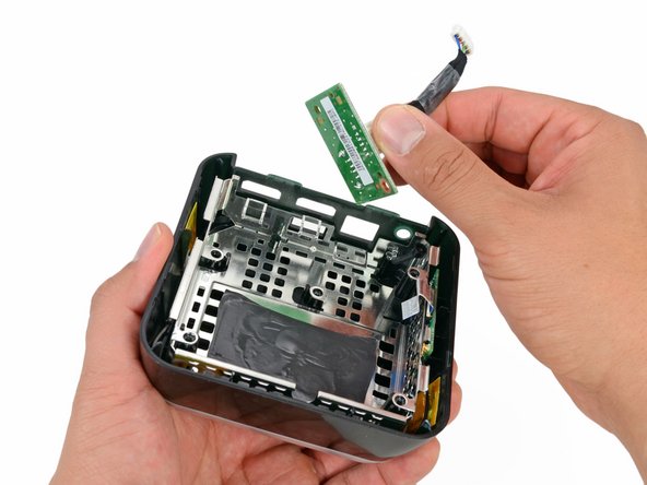

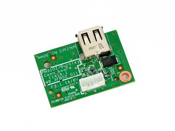

    • We remove an additional board to reveal a whole lot of nothin' underneath.
    • The board houses the USB port and, well, nothing else.

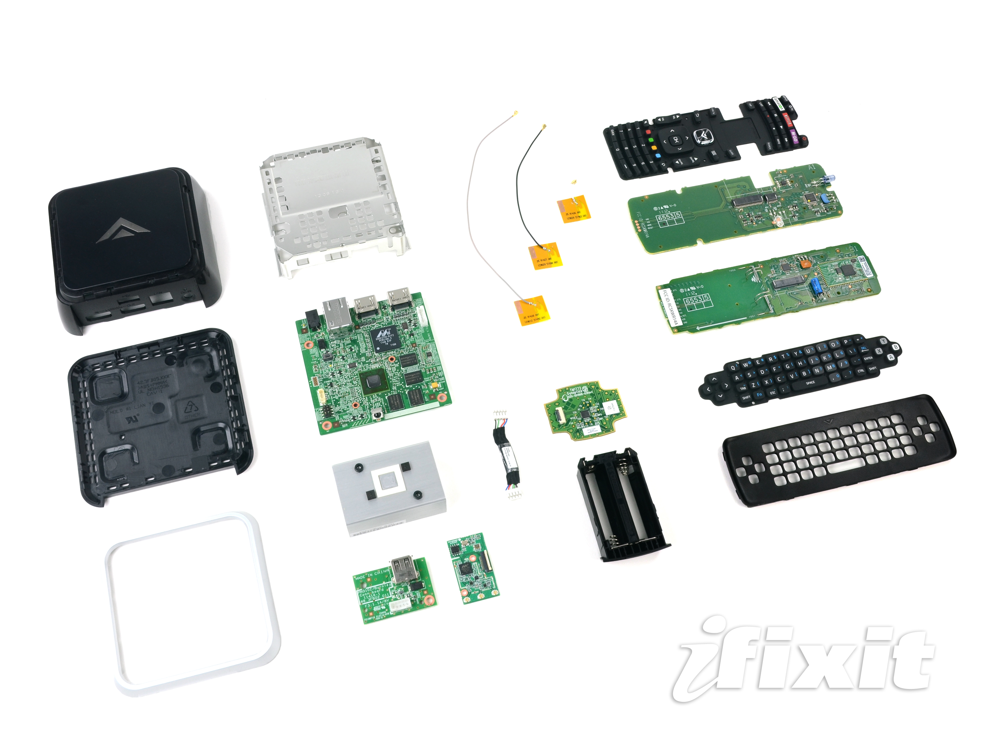

    • That's pretty much it for the Co-Star, but we do like to do a thorough teardown here at iFixit, so we took a quick look at this flashy silver bezel. It sadly revealed nothing more than a flashy silver bezel.
    • Modders, take note: the bezel comes off easily and would probably look pretty slick when painted neon green.
