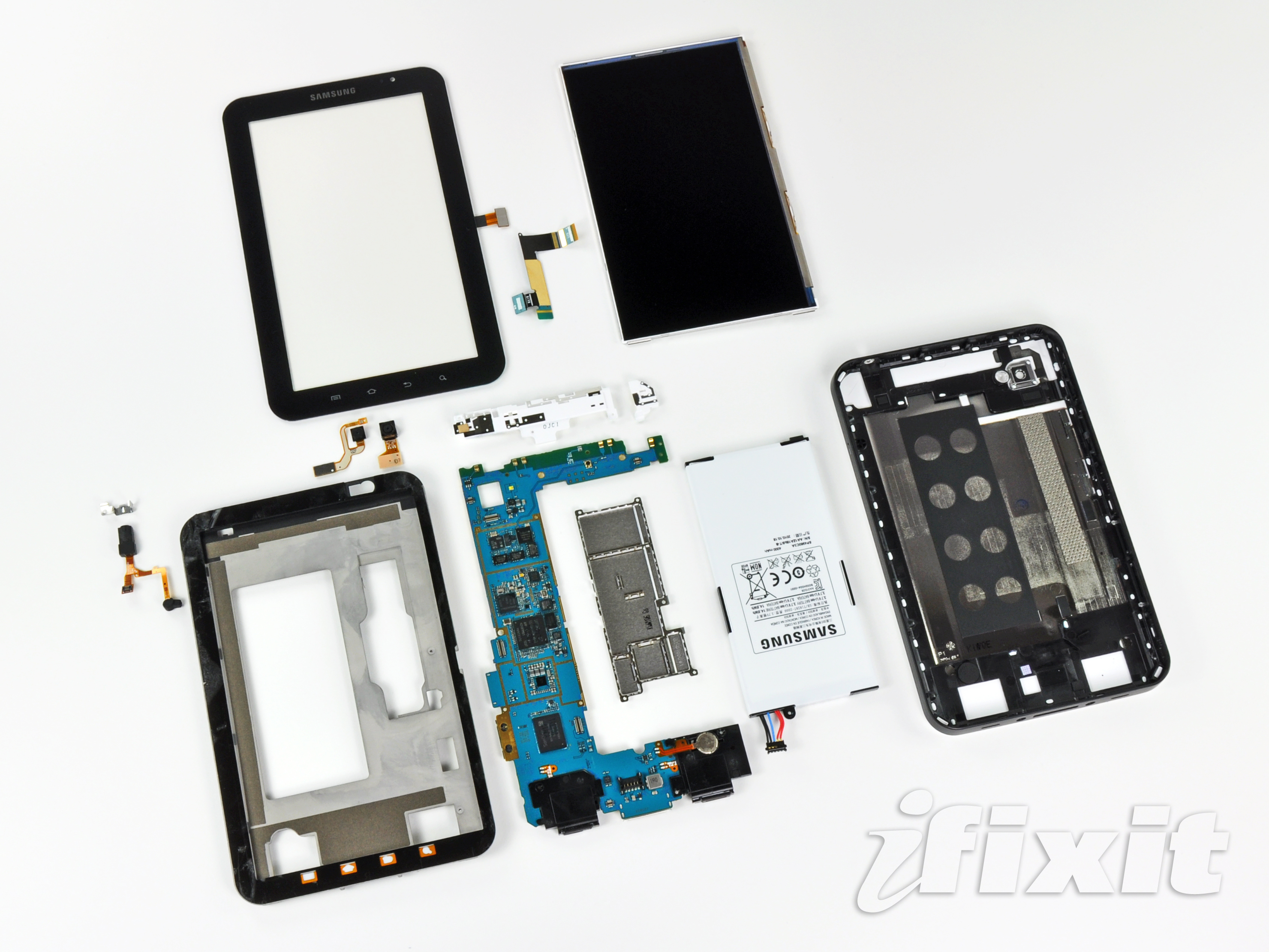

  6. Samsung Galaxy Tab Teardown: step 6, image 1 of 3 Samsung Galaxy Tab Teardown: step 6, image 2 of 3 Samsung Galaxy Tab Teardown: step 6, image 3 of 3
    • Using a combination of plastic opening tools and guitar picks, the front panel is pried upward around its perimeter to release it from the plastic rear case.
    • Luckily, the Galaxy Tab doesn't use any self destructing copper retaining clips like the iPad.

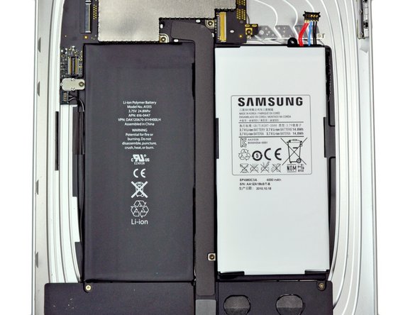

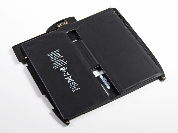

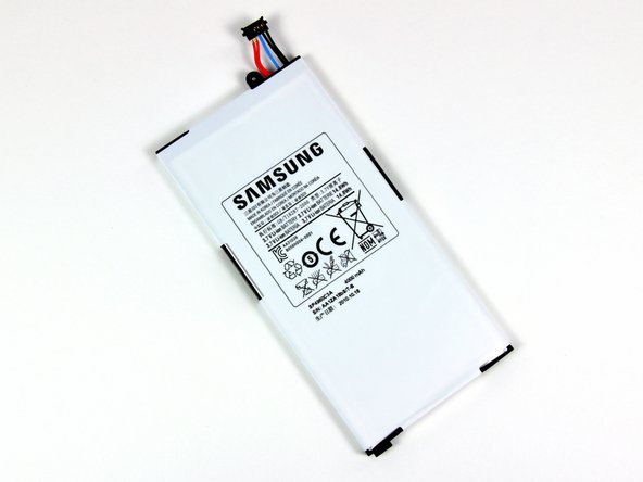

  9. Samsung Galaxy Tab Teardown: step 9, image 1 of 3 Samsung Galaxy Tab Teardown: step 9, image 2 of 3 Samsung Galaxy Tab Teardown: step 9, image 3 of 3
    • The 3.7V Li-Ion battery inside the Galaxy Tab lists a capacity of 14.8 Watt-hours or 4000 mAh.
    • Samsung claims that the battery provides enough juice to watch seven hours of movies.
    • That seven hours isn't quite enough to last you though your favorite movie trilogy, something that the iPad would handle with ease.
    • Weighing in at 81 grams, the Galaxy Tab's battery is about 55% the weight and 60% the capacity of the iPad's hulk of a battery.
    • As highlighted in the third picture, the Galaxy Tab's battery is approximately half the size of the iPad's battery.

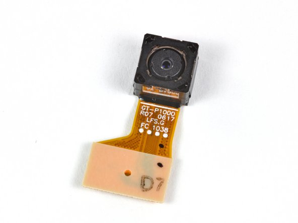

  10. Samsung Galaxy Tab Teardown: step 10, image 1 of 3 Samsung Galaxy Tab Teardown: step 10, image 2 of 3 Samsung Galaxy Tab Teardown: step 10, image 3 of 3
    • The rear-facing camera connector is pried up from its socket on the motherboard with the edge of an opening tool.
    • Say goodbye to the rear-facing camera...

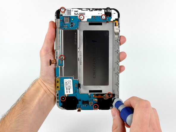

  11. Samsung Galaxy Tab Teardown: step 11, image 1 of 3 Samsung Galaxy Tab Teardown: step 11, image 2 of 3 Samsung Galaxy Tab Teardown: step 11, image 3 of 3
    • Removing the motherboard requires disconnecting several connectors:
    • Headphone jack/microphone cable
    • Volume control cable
    • Touchscreen cable
    • Control button LED cable
    • Display data cable
    • The motherboard is secured the rear panel by seven Phillips screws.
    • Removing the motherboard requires lifting it away from the rear panel.

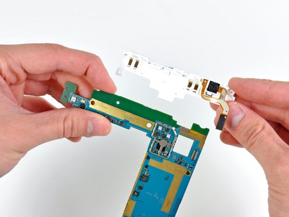

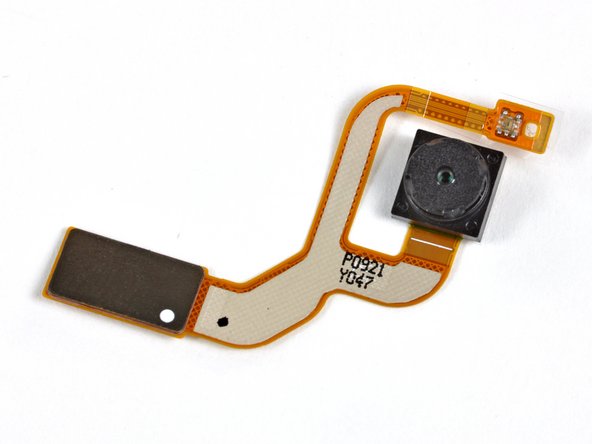

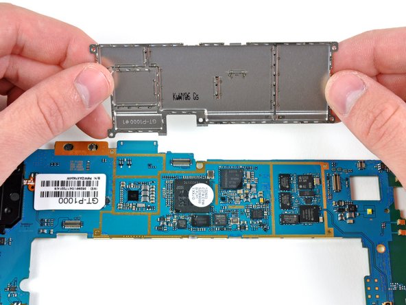

  12. Samsung Galaxy Tab Teardown: step 12, image 1 of 3 Samsung Galaxy Tab Teardown: step 12, image 2 of 3 Samsung Galaxy Tab Teardown: step 12, image 3 of 3
    • The front facing camera easily separates from the motherboard assembly.
    • Let's lift that ugly EMI shield so we can take a peek at the Galaxy Tab's circuitry.

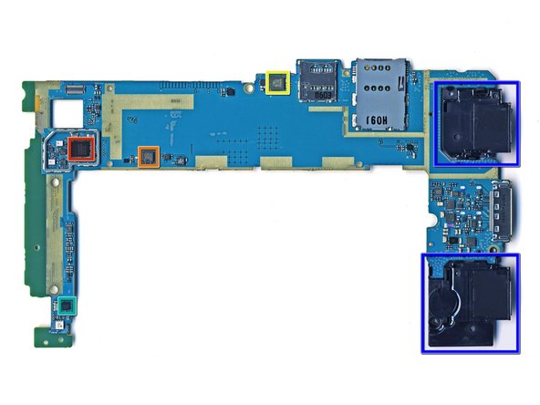

  13. Samsung Galaxy Tab Teardown: step 13, image 1 of 1
    • Front side of the motherboard. These identifications are credited to UBM TechInsights.
    • Let's examine the lineup:
    • SanDisk SDIN4C2-16G (MLC NAND Flash 16 GB)
    • Maxim 8998 (Power Management IC)
    • Samsung S5PC110A01 + Samsung KB100D100YM (1GHz Hummingbird Multimedia Applications Processor + 8 Gb of MLC Flex OneNAND, 1 Gb of OneDRAM, and 3 Gb of mobile DDR).
    • Infineon PM9801 (X-GOLD 616 HSDPA/HSUPA/EDGE Modem Solution)
    • Wolfson Microelectronics WM8994 (Audio Codec)
    • Infineon PMB5703 (RF Transceiver)
  14. Samsung Galaxy Tab Teardown: step 14, image 1 of 1
    • Back side of the motherboard.
    • Chip lineup continued:
    • Broadcom BCM4329 (Bluetooth/FM/WLAN receiver)
    • STMicroelectronics L3G4200D (Gyroscope)
    • ATMEL MXT224 (touchscreen controller)
    • Broadcom BCM4751 (GPS receiver)
    • Two loudspeakers near the dock connector provide on-board audio for the Galaxy Tab.

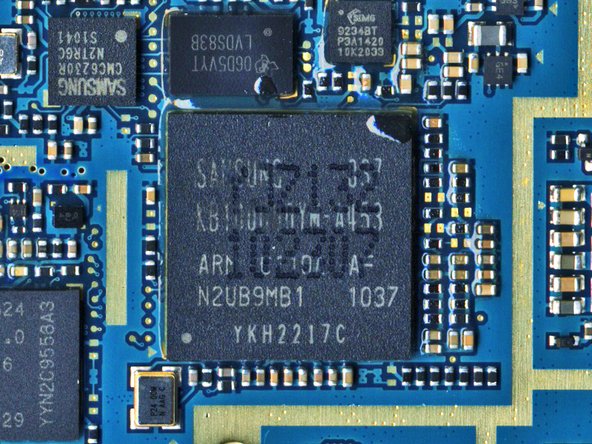

  15. Samsung Galaxy Tab Teardown: step 15, image 1 of 1
    • So what makes the Samsung Galaxy Tab a true iPad competitor? The answer lies in the processor.
    • The Galaxy Tab is powered by the Samsung S5PC110A01 Multimedia Applications Processor.
    • Much like the iPad's A4 processor, the 1 GHz Hummingbird processor is an ARM processor featuring package-on-package construction to improve the speed and efficiency of internal processes.
    • Samsung takes advantage of the Package-on-Package architecture by embedding 8Gb of MLC Flex OneNAND, 1 Gb of OneDRAM and 3Gb of Mobile DDR into the processor.
    • The iPad's A4 processor embeds two layers of RAM (Samsung K4X1G323PE) into the processor's three layers.

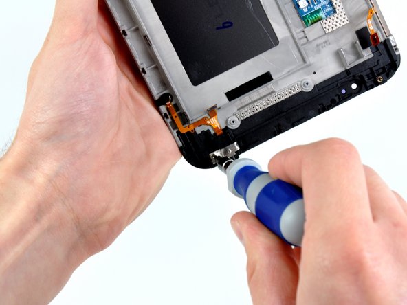

  16. Samsung Galaxy Tab Teardown: step 16, image 1 of 3 Samsung Galaxy Tab Teardown: step 16, image 2 of 3 Samsung Galaxy Tab Teardown: step 16, image 3 of 3
    • One Phillips screw secures the headphone jack/microphone assembly to the rear panel.
    • After lifting it off some adhesive, it can be removed from the Galaxy Tab.
    • Luckily, the headphone jack is completely separate from the motherboard, making replacement trivial if you happen to break it when you drop your Galaxy Tab with the headphones plugged in.

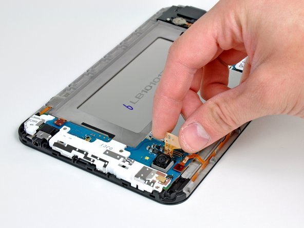

  17. Samsung Galaxy Tab Teardown: step 17, image 1 of 1
    • After prying it up from the chassis and unlocking the ZIF socket, the display data interconnect cable can be removed from the front panel assembly.

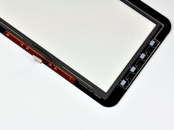

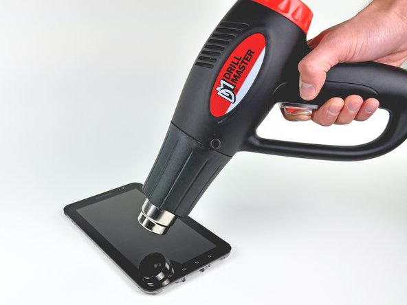

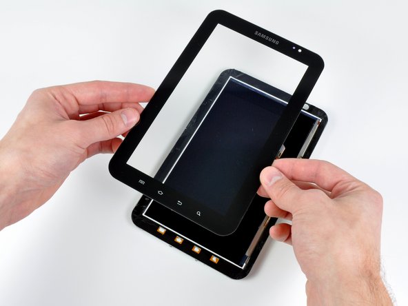

  18. Samsung Galaxy Tab Teardown: step 18, image 1 of 3 Samsung Galaxy Tab Teardown: step 18, image 2 of 3 Samsung Galaxy Tab Teardown: step 18, image 3 of 3
    • Unfortunately, a fair amount of heat is required to remove the front panel.
    • After a few blasts with a heat gun and some nervous prying, the front panel can be separated from the chassis.
    • The digitizer element was produced by Atmel and is bonded to a Corning Gorilla Glass front panel.
    • Apparently, the Galaxy Tab can also double as body armor.

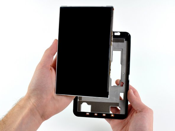

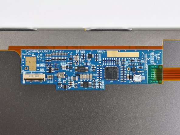

  19. Samsung Galaxy Tab Teardown: step 19, image 1 of 2 Samsung Galaxy Tab Teardown: step 19, image 2 of 2
    • The screen on the Galaxy Tab is a Super TFT LCD, allowing for better image quality and viewing angle than a typical LCD.
    • Although the resolution of the Galaxy Tab's screen (1024x600) is less than the resolution of the iPad (1024 x 768), the Galaxy Tab has a more pixels-per-inch (169 for Galaxy Tab vs 132 for the iPad).
    • 169 ppi is nice, but nowhere near dense enough for us. We vastly prefer the iPhone 4's 326 ppi retina display.

Just a Quick Question:
The Camera seems easy to remove. Is it a Standard Camera Module that can be SWAPPED for a higher Mega Pixel Version that can be sourced readily? This VERY Poor camera seems to be holding the Tab Back!
Alap R Naik Desai - Reply
