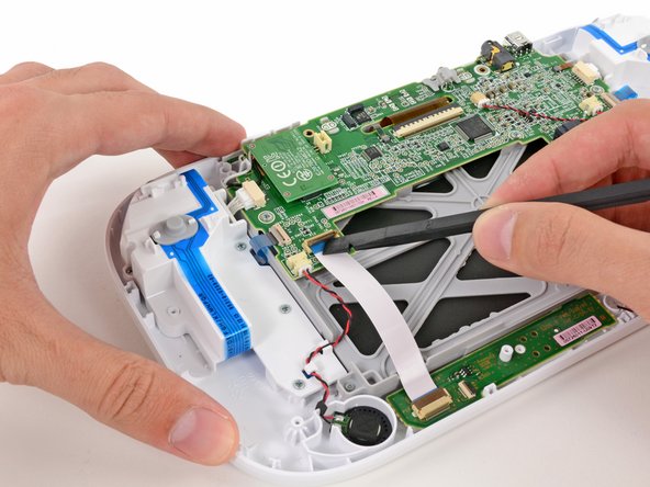

  17. Nintendo Wii U Teardown: step 17, image 1 of 3 Nintendo Wii U Teardown: step 17, image 2 of 3 Nintendo Wii U Teardown: step 17, image 3 of 3

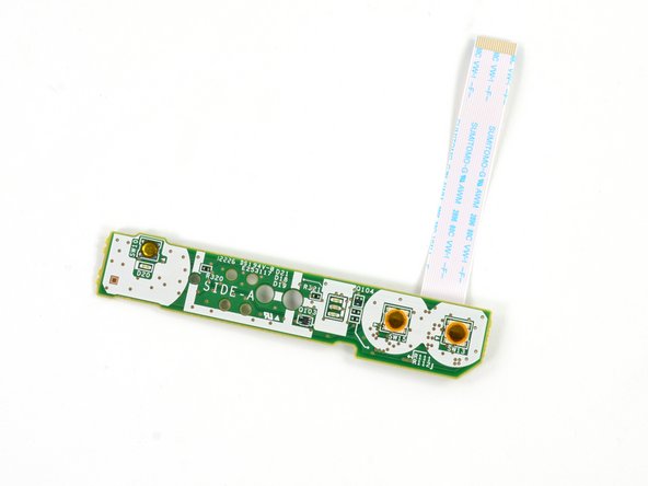

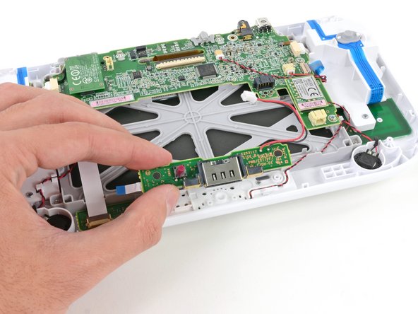

    • A simple ZIF connector stands between us and the bottom button board.
    • The bottom button board is home to the TV control and power buttons.
    • Despite the board housing two of the most important buttons, there are no conspicuous ICs on the bottom button board.

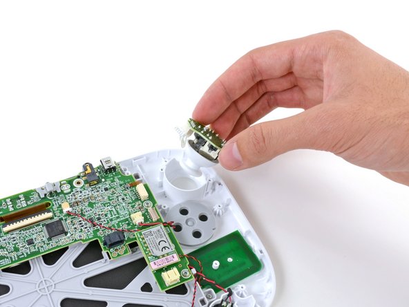

    • This button casing is wrapped in blue ribbon cables and switches for the ABXY button pad.
    • With the button casing out of the way, we get to the first of the dual analog joysticks.

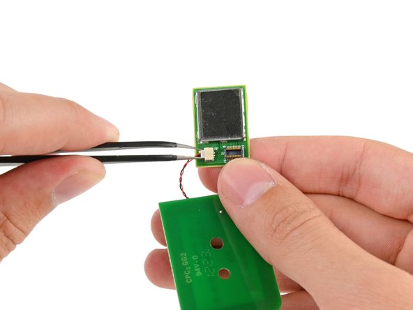

  21. Nintendo Wii U Teardown: step 21, image 1 of 3 Nintendo Wii U Teardown: step 21, image 2 of 3 Nintendo Wii U Teardown: step 21, image 3 of 3
    • The Wii U loses its ability to communicate with near fields as we remove the NFC module and antenna.
    • What awesome functionality did this bring to the console?
    • Well, as of launch day…none.
    • In the future, we might see loading saved games or importing characters from cards or action figures, like in this demo.

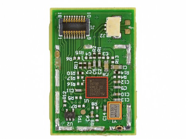

    • There are two prominent ICs on the NFC communications board:
    • Broadcom BCM20792 KMLG NFC controller
    • T130 MsEU crystal oscillator

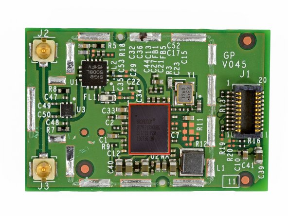

  22. Nintendo Wii U Teardown: step 22, image 1 of 3 Nintendo Wii U Teardown: step 22, image 2 of 3 Nintendo Wii U Teardown: step 22, image 3 of 3
    • Pulling out this (third) dual-antenna wireless module is starting to feel pretty routine.
    • The board is powered by a Broadcom BCM4319XKUBG.
    • This module is likely part of a new system Nintendo and Broadcom co-designed to wirelessly stream video and data between the Wii U console and GamePad controller.

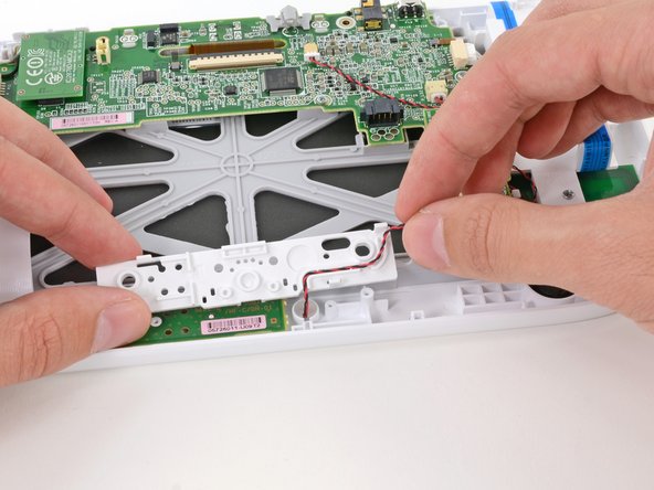

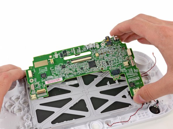

    • The GamePad's motherboard is easily displaced from the front panel case.
  24. Nintendo Wii U Teardown: step 24, image 1 of 1
    • Front side of the GamePad's motherboard:
    • STMicroelectronics UIC-WUP MCE GH226
    • STMicroelectronics MSA3D 01F
    • Texas Instruments TSC2046I Low Voltage I/O Touch Screen Controller
  25. Nintendo Wii U Teardown: step 25, image 1 of 1
    • The backside of the GamePad's motherboard:
    • InvenSense ITG-3280 Gyroscope
    • Micron MT25Q256A 256 Mb Serial Flash
    • DRC-WUP 811309J31 1217LU603
    • Texas Instruments AIC3012 Audio Converter
    • Texas Instruments 1010007
  26. Nintendo Wii U Teardown: step 26, image 1 of 3 Nintendo Wii U Teardown: step 26, image 2 of 3 Nintendo Wii U Teardown: step 26, image 3 of 3

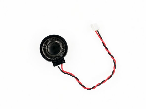

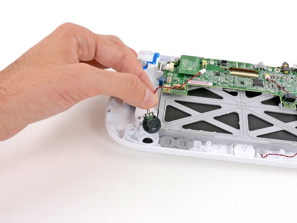

    • Just a few more components block our path to the 6.2-inch touch screen display.
    • First out are the dual antennas that transfer the GamePad controller's wireless signal back to the Wii U console.
    • The microphone and remaining speaker were previously blocked in place underneath the motherboard, but are now easily removed.

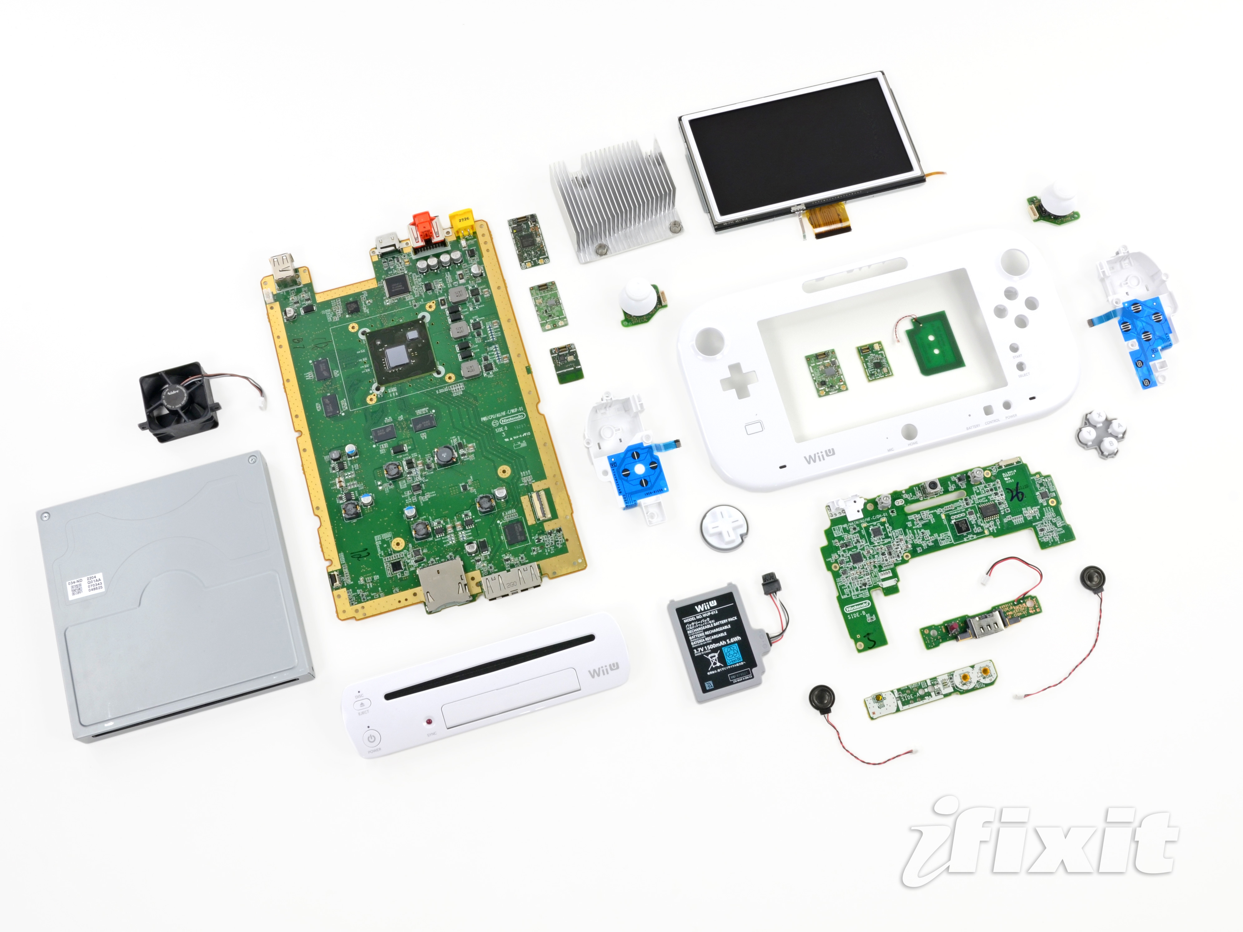

    • It has been a Wii-ld ride, but this teardown is complete. Time to assign a score!

Renzo - Reply
I thought the gyroscope was from PNI sensor. Not Invensense???
