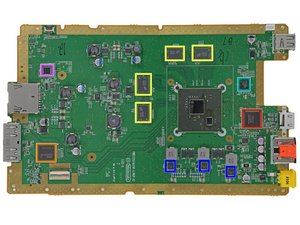

IC U! The notable players on the motherboard:
Panasonic MN864718 HDMI Controller
Samsung KLM8G2FE3B eMMC 8 GB NAND Flash/Memory Controller
Micron 2LEI2 D9PXV [part number MT41K256M16HA-125] 4 Gb DDR3L SDRAM (4 x 4 Gb for a total of 16 Gb or 2 GB RAM)
DRH-WUP 811309G31
Fairchild DC4AY
SMC 1224EE402
Samsung K9K8G08U1D 4 Gb (512 MB) NAND Flash
