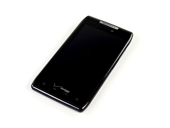

  2. Motorola Droid RAZR Teardown: step 2, image 1 of 2 Motorola Droid RAZR Teardown: step 2, image 2 of 2
    • We have heard some mighty claims about the thinness of this phone, but how thin is it really?
    • Oh ... that thin. The claims are true; this phone is pretty darn thin.
    • The RAZR measures in at a mere 0.28 inches thin and increases to 0.42 inches at its love-handle the prevalent Motorola camera bulge.
    • For comparison, Verizon boasted with the release of the Droid Bionic in September that it was the slimmest 4G LTE phone at 0.43 inches thick.
    • There is no doubt that the Droid RAZR is exceptionally thin, but Motorola had to fit the internals somewhere. To compensate, the RAZR is also rather large, measuring in at 5.15 inches long and 2.71 inches wide.

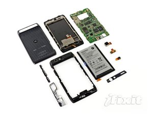

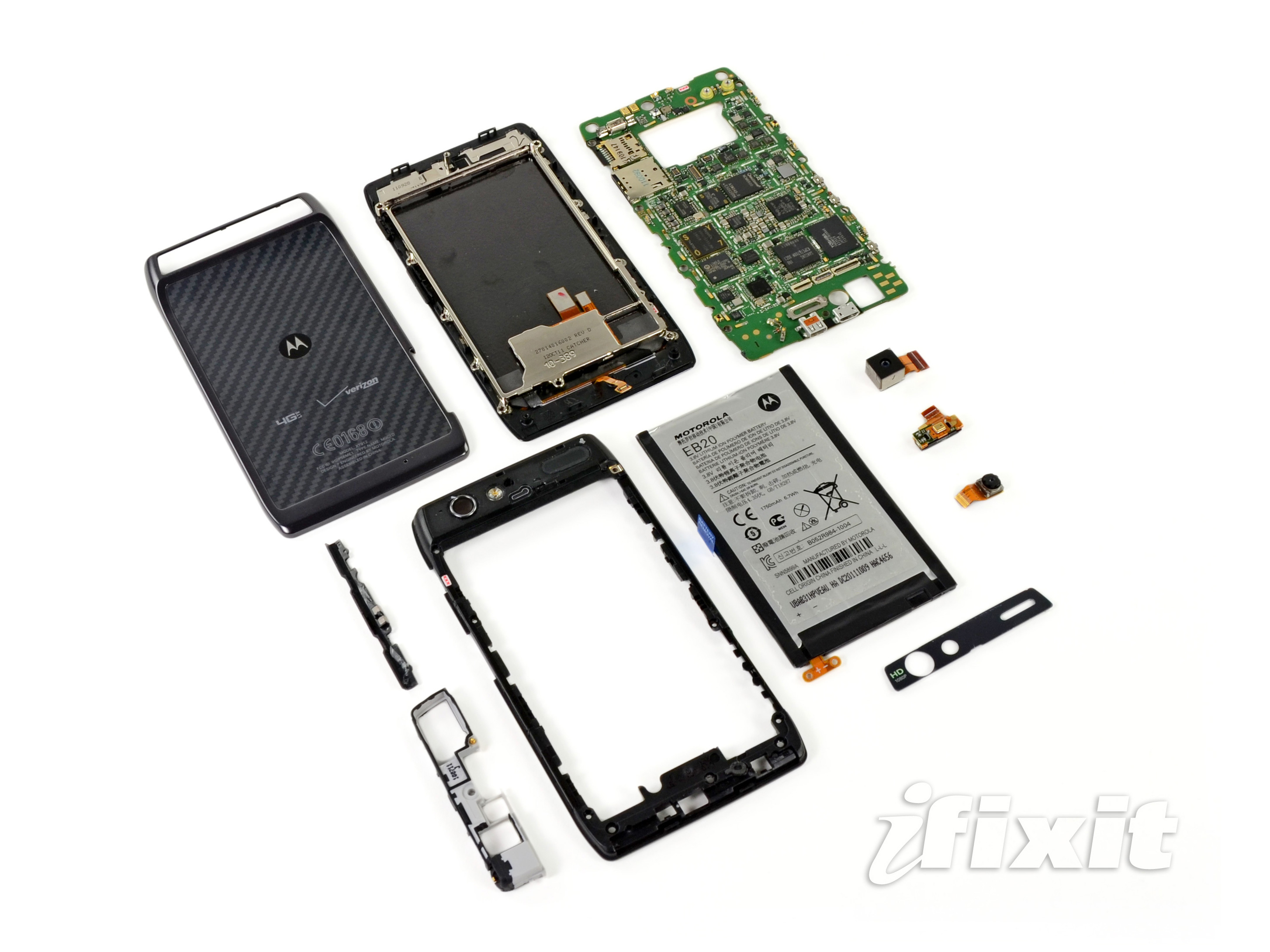

    • Holy cannoli! Look at all 'em chips! To keep the design svelte, Motorola packed pretty much everything on one side of the mobo. Let's see what we're dealing with:
    • Toshiba THGBM4G7D2GBAIE 16GB EMMC Flash Memory
    • Samsung K3PE7E700M-XGC1 4Gb LPDDR2 RAM
    • Qualcomm MDM6600 Dual-Mode Baseband/RF Transceiver
    • Qualcomm PM8028 Power Management IC
    • Avago ACPM-7868 Quad-Band Power Amplifier
    • Motorola T6VP0XBG-0001 (believed to be the LCM 2.0 LTE baseband processor)
    • Texas Instruments WL1285C Wilink 7 Bluetooth/Wi-Fi/GPS

    • Motorola Droid RAZR Repairability Score: 4 out of 10 (10 is easiest to repair).
    • Once the battery and motherboard are within reach, replacement is easy—no soldering required.
    • The "non-serviceable" back was a bit of a pain to remove.
    • The front panel is adhered to the AMOLED display, so they must be replaced as one expensive unit.
    • All plastic frames and casing proved to be incredibly tedious to remove, and felt like they would break at any moment.
    • There are copious amounts of adhesive holding the phone together.
