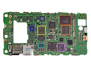

Holy cannoli! Look at all 'em chips! To keep the design svelte, Motorola packed pretty much everything on one side of the mobo. Let's see what we're dealing with:
Toshiba THGBM4G7D2GBAIE 16GB EMMC Flash Memory
Samsung K3PE7E700M-XGC1 4Gb LPDDR2 RAM
Qualcomm MDM6600 Dual-Mode Baseband/RF Transceiver
Qualcomm PM8028 Power Management IC
Avago ACPM-7868 Quad-Band Power Amplifier
Motorola T6VP0XBG-0001 (believed to be the LCM 2.0 LTE baseband processor)
Texas Instruments WL1285C Wilink 7 Bluetooth/Wi-Fi/GPS
