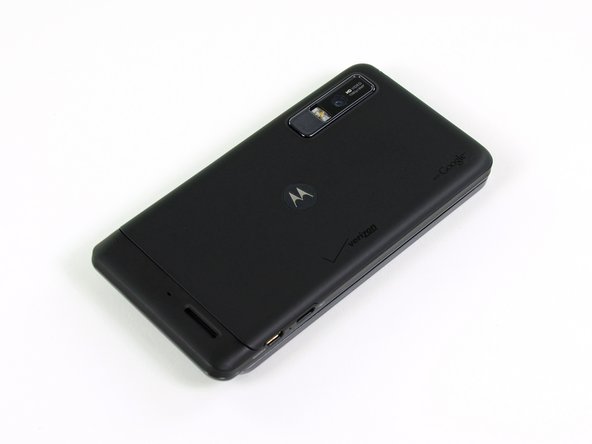

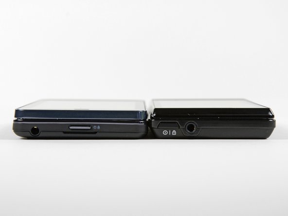

    • Motorola advertises that the Droid 3 is the "Thinnest Full QWERTY Smartphone Ever."
    • When compared to the original Droid, it is clear that the Droid 3 is smaller. However, the thickness difference is hardly something to brag about.
    • The rear-facing camera on the Droid 3 includes an LED flash and 8x zoom capability.
    • The Droid 3 features both micro USB and micro HDMI ports, allowing for full 1080p output to any compatible device.
    • The port layout on the left side gives the Droid 3 an uncanny resemblance to the Motorola Atrix.

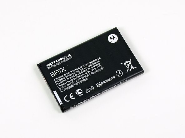

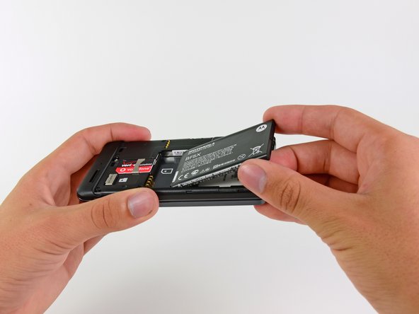

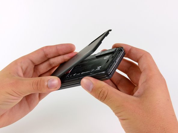

    • Pulling off the back cover gives us our first glimpse at the user-replaceable battery.
    • Motorola claims that the battery inside the Droid 3 will last for over 9 hours of continuous talk time, or over 300 hours of continuous stand-by time.
    • We suspect, however, that having the phone in standby for 300 hours would be very, very boring.
    • The battery is rated at 3.7 V and 1540 mAh.
  4. Motorola Droid 3 Teardown: step 4, image 1 of 3 Motorola Droid 3 Teardown: step 4, image 2 of 3 Motorola Droid 3 Teardown: step 4, image 3 of 3

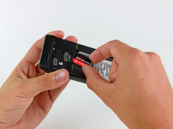

    • Whoa! This Droid has a SIM card!
    • CDMA, the network protocol for Verizon, does not require SIM cards.
    • A lack of SIM cards severely hampered international use of Verizon's network. This SIM will enable the Droid 3 to be used almost anywhere in the world.
    • For a more complete explanation of Verizon, CDMA, SIM cards, and other, similar things, check out our Verizon iPhone Teardown.
    • A very attention-grabbing informational card included with the phone is neon orange for a reason. For some regions outside the USA, data charges might be as high as $20.48 per MB!

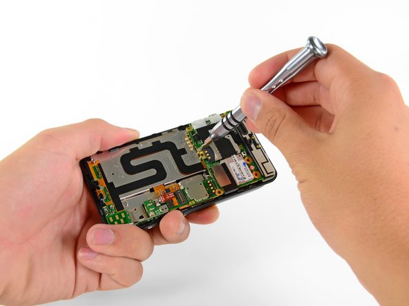

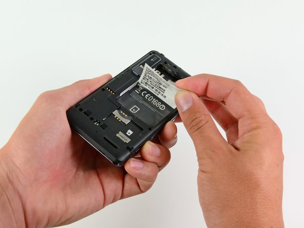

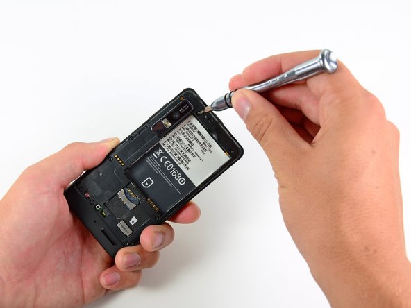

    • Like its predecessors, the Droid 3's rear case is held in place by a few T5 Torx screws.
    • Motorola likes to hide screws and latches beneath the information label, making opening the phone a rather sticky affair.
    • Of course, these obstacles are of little challenge to our spudgers, 54-piece bit driver kits, and talented fingers.
    • With the screws unscrewed, the clips unclipped, and the stickers unsticked, we get a full-on exposè of the Droid 3's innards.

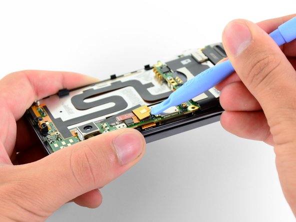

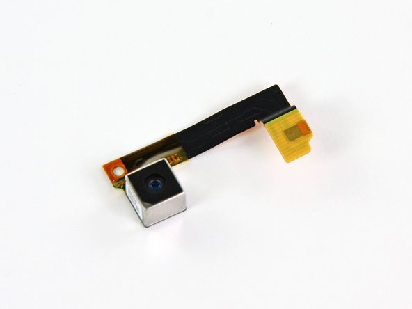

    • Next, we use a plastic opening tool to lift the camera ribbon cable off its socket on the motherboard.
    • The Droid 3 is equipped with an 8 MP rear-facing camera capable of recording 1080p video at 30 fps.

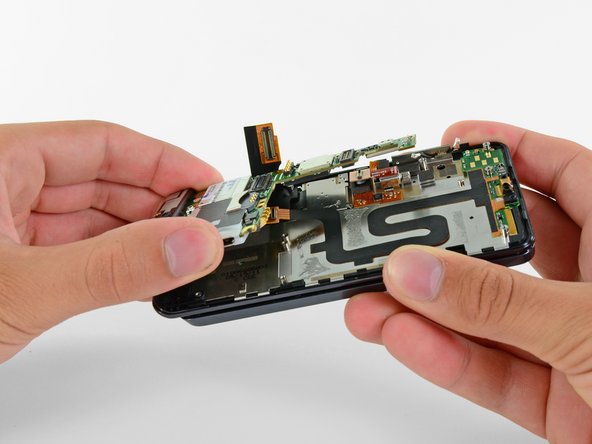

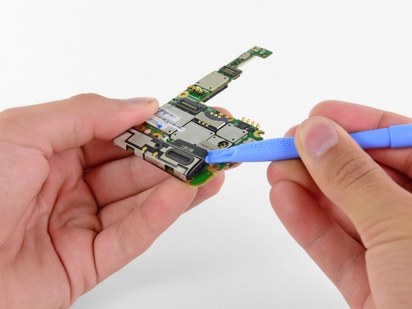

    • Adiós motherboard screws, we hardly knew you...
    • After removing a few more connectors, the motherboard easily lifts off the phone.
    • In order to strip the motherboard bare, the speaker/antenna assembly must be pried off of the board.
    • The speaker assembly uses pressure contacts to transmit data to both the speaker and the antenna. Interestingly, a hole through the motherboard allows sound to pass through for better transmission to the outside of the phone.

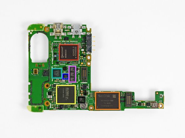

    • The main ICs on the front side of the motherboard include:
    • Qualcomm MDM6600 supporting HSPA+ speeds of up to 14.4 Mbps
    • SanDisk SDIN4C2 16GB MLC NAND flash
    • Elpida B4064B2PB-8D-F 512MB RAM and TI OMAP 4430 CPU
    • Triquint TQM7M5013 Linear Power Amplifier
    • Avago A2F1106
    • A5005 K1116, A5002 K1118, A5001 K1118 (from bottom to top)
    • Kionix KXTF9 11425 1411 three-axis accelerometer

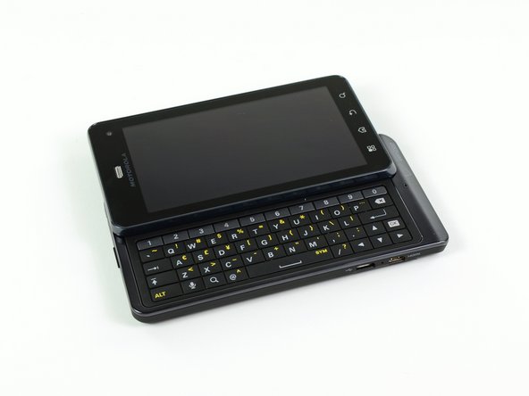

    • One of the most important features on the Droid 3 is its 5-row slide-out full QWERTY keyboard.
    • We like the offset keys on the Droid 3, a feature that was frustratingly absent in the original Droid, but added in the Droid 2.

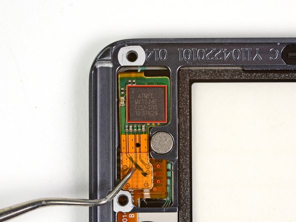

    • With a little encouragement, the qHD LCD lifts out of the Gorilla Glass-equipped front panel.
    • The screen in the Droid 3 is 0.3" larger than the screens in both of its predecessors, measuring in at a total of 4". It also has a higher resolution, at 960 x 540 pixels.
    • The ribbon cable attached to the rear of the LCD holds the earpiece speaker, the front-facing camera, the ambient light sensor, and the notification LED. Phew!
    • All of these components on one ribbon cable makes disassembly easy, but repair costly.
    • An Atmel MXT224E capacitive touchscreen controller can be found within the front panel.

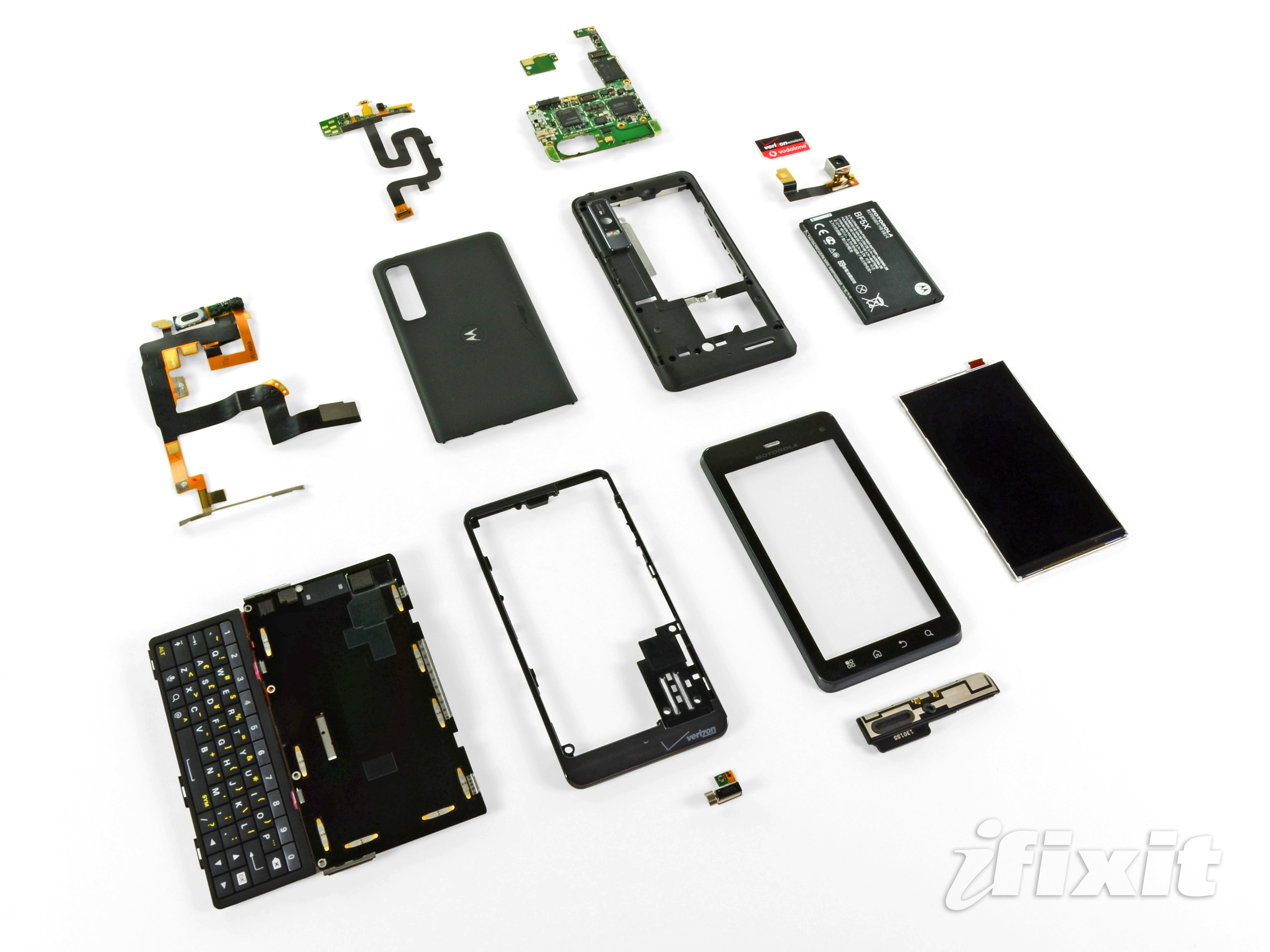

    • The Motorola Droid 3 (Droid3) earns itself a repairability score of 6 out of 10.
    • There were no security screws in the entire device.
    • The battery was not soldered to anything and was easy to replace.
    • Many components are mounted to a single ribbon cable, meaning that replacing one requires replacing them all.
    • There is a lot of adhesive holding things together, making disassembly and reassembly difficult.
    • To get to the LCD, the entire device has to be taken apart.
