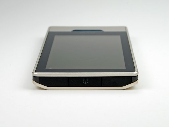

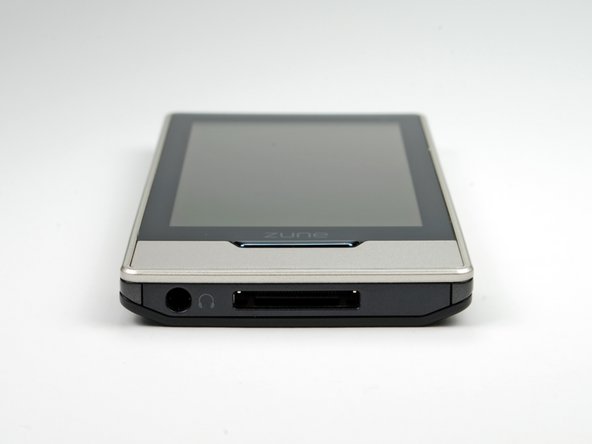

    • We got our hands on a brand new Zune HD. It's a very pretty device, but that will not spare it from the knife.
    • Sparing no expense, we got the 32 GB "Platinum" model. However, it seems you need to spend an additional $90 if you want to get HD out of the Zune HD...
    • To Microsoft's credit, our 32 GB Zune was $10 less than the 32 GB iPod touch we took apart last week. However, if you want more than 32 GB in your Zune, you're out of luck for now.

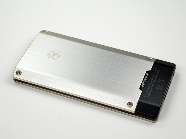

    • The Zune is lighter than it looks. It weighs in at only 2.6 oz (74 grams). That's more than 35% less than the similarly-sized iPod touch.

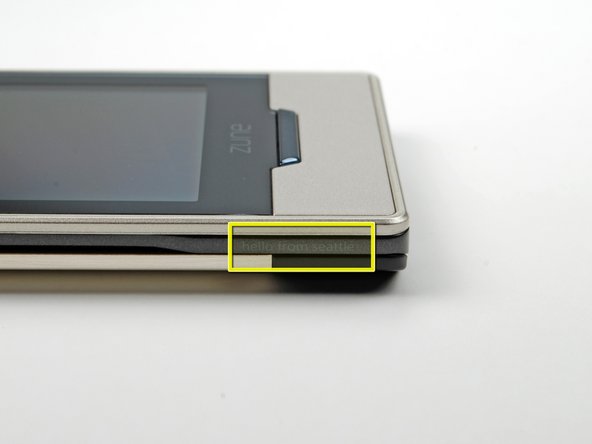

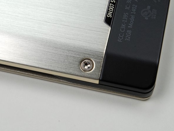

    • Microsoft even left us a message! (picture 3). Hello to you Seattle from San Luis Obispo!
    • The Zune HD is 102.1 mm x 52.7 mm x 8.9 mm, while the iPod touch is 110 mm x 61.8 mm x 8.5 mm. If the iPod touch were square, it would have 20% more volume than the Zune. We could integrate to calculate the area under those curves, but we'll save that fun stuff for you mathletes out there.

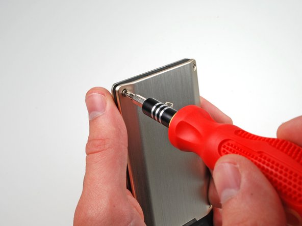

    • Unlike Apple, Microsoft doesn't seem to be afraid to show off their screws. They probably don't want everyone doing what we're about to do, so they've adorned the Zune's exterior with tri-wing screws.
    • The black plasic strip at the bottom of the Zune reminds us of the original iPhone.

    • Tri-wing screwdriver to the rescue!
    • There's no "warranty void" sticker or seal to break when opening the Zune. Thanks Microsoft!

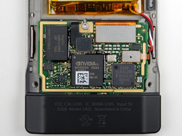

    • The lovely internals.
    • NVIDIA Tegra processor front and center. In a stark contrast to Apple's relationship with Samsung, NVIDIA's product page actually has a link to buy the Zune HD.
    • To the right is the SiPORT HD Radio receiver. This chip supports AM, FM, HD Radio, Microsoft MSN Direct Data Services, and a slew of other frequencies (including the Weather Band).
    • The SDRAM is Hynix! H5MS1G22MFP J3M 926A. In the upper left, is a 1 gigabit Hynix Mobile DDR SDRAM.
    • The accelerometer is below the Hynix SDRAM and to the left of the Nvidia processor. It's a Kionix KXSD9.

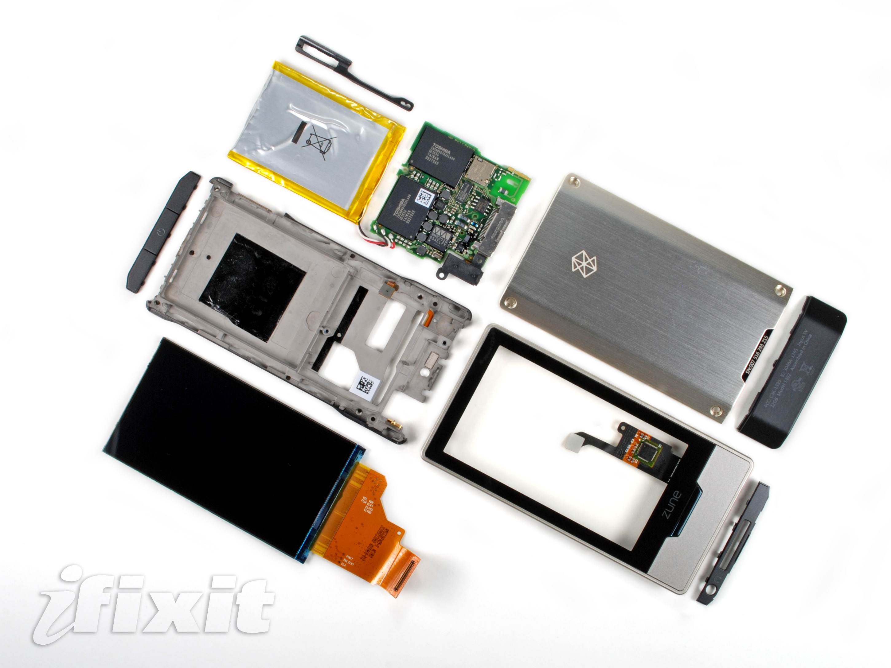

    • Zune HD, displayed in nine easy-to-assemble pieces!
    • We found components inside from Atheros, Atmel, Avago, Kionix, Phison Electronics, RiT Display, Samsung, Toshiba, Foxxcon, and Wolfsom Micro. Did we miss one? Let us know.
